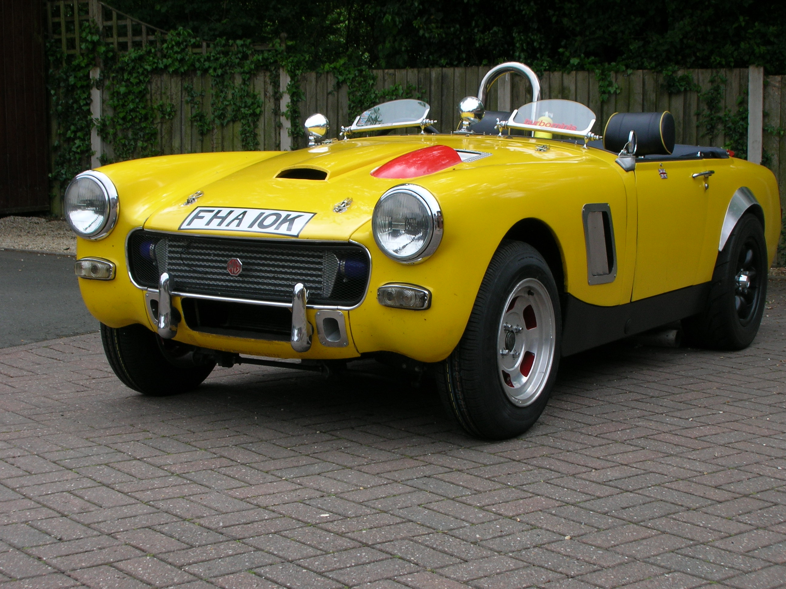

Quick update.After many problems with fuel blockages in the carb.I changed all the fuel lines to unleaded compatible flexis,added a filter just before the carb and now have all fingers crossed.Also replaced the 276 cam with a Piper ph2,advanced 3 deg and seem to have recovered peak torque at 4000 rpm.The clutch cried enough and was replaced with an Escort Mexico cover which is much stronger.Finally got back to Shakey this weekend and began to get the car to hook up.Recorded a best of 13.7/100 still with 2.0 sec 60 ft.All this without the Nitrous.Met Neil(sideways GTM) there,running around 11 secs all day (jeez!) and he gave me some good advice on burnouts.Also supercharged outlaws there,plus a guy with a Honda Vtec plus Nitrous in an oversized kart.Was next up on one run and I swear if the lane had been any narrower he would have hit the barrier on both sides.
Pic below is the car with the Wolfies now fitted 8-)
