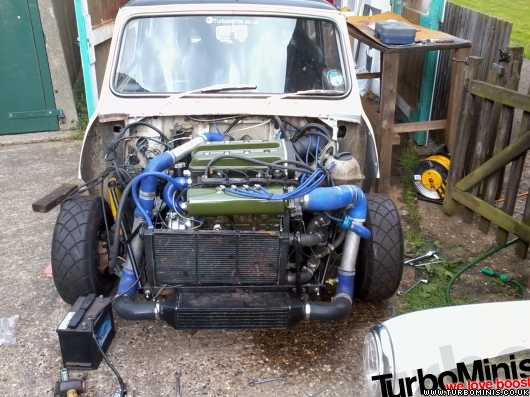

pics of the rad in sort of!
how have people mounted the fiat chiq radiator?
thanks for looking
My build thread..
This is mine.
I have one mount coming off the drivers brace bar and one off the front left of the subby. These are the original cricular mounts with the rubber bushes fitted.You can just about see them here.

it's been awhile since i up dated this but i have been doing bits and pieces today. really want to get this thing built now!!!
made some brackets for the chinq rad.....
fitted the grille
blocked up some more unwanted holes...
made and fitted the plates for the bonnet pins...
this is where im going to mount the oil cooler...
i'll think of a way to get some sort of duct to it to make sure enough air gets too it.
hopefully i will keep the updates more frequent from now on!! :)

So I've got the bug again!!:)

Hi mate looks good! But is that gear change bracket the right way round?
JT
2742 Posts
Member #: 637
Hertfordshire
probably not lol I will have another look at it next weekend. That's the reason I put pics up ay :)
I've got to workout how to route the intercooler pipes round the KAD master cylinders as well! lol

That front bracket looks like it should be the other way round!
