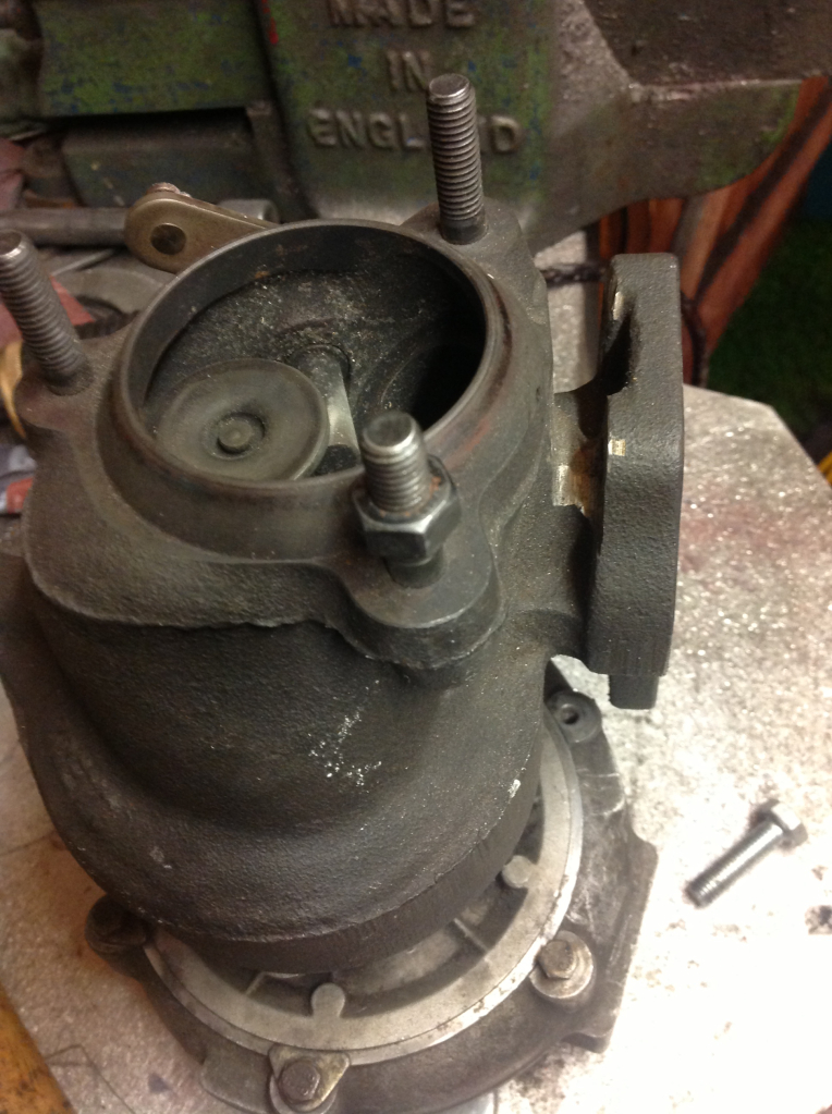

looks amazing, got a couple of questions though, i assume studs are required to fit the turbo but this will require the turbo manifold drilling out and how the hell do you get a nut on one of the bottom bolts without grinding the turbo housing. I can only assume its the latter, need to order studs if im right and k nuts.

I'm in the same boat mate, need to find out what everyone else has done, everyone must have had the same issue, even with the standard manifold
Grind a bit out of the turbo housing.

as andy says you can grind a small amount off the turbo housing as per the photo attached.
or you can put a stund in the none accessable fixing and drill out the treads on the manifold.
personally i'll be grinding the housing.

Mounted the turbo on the maifold as per Matty's instructions and ground the lug off the back.
