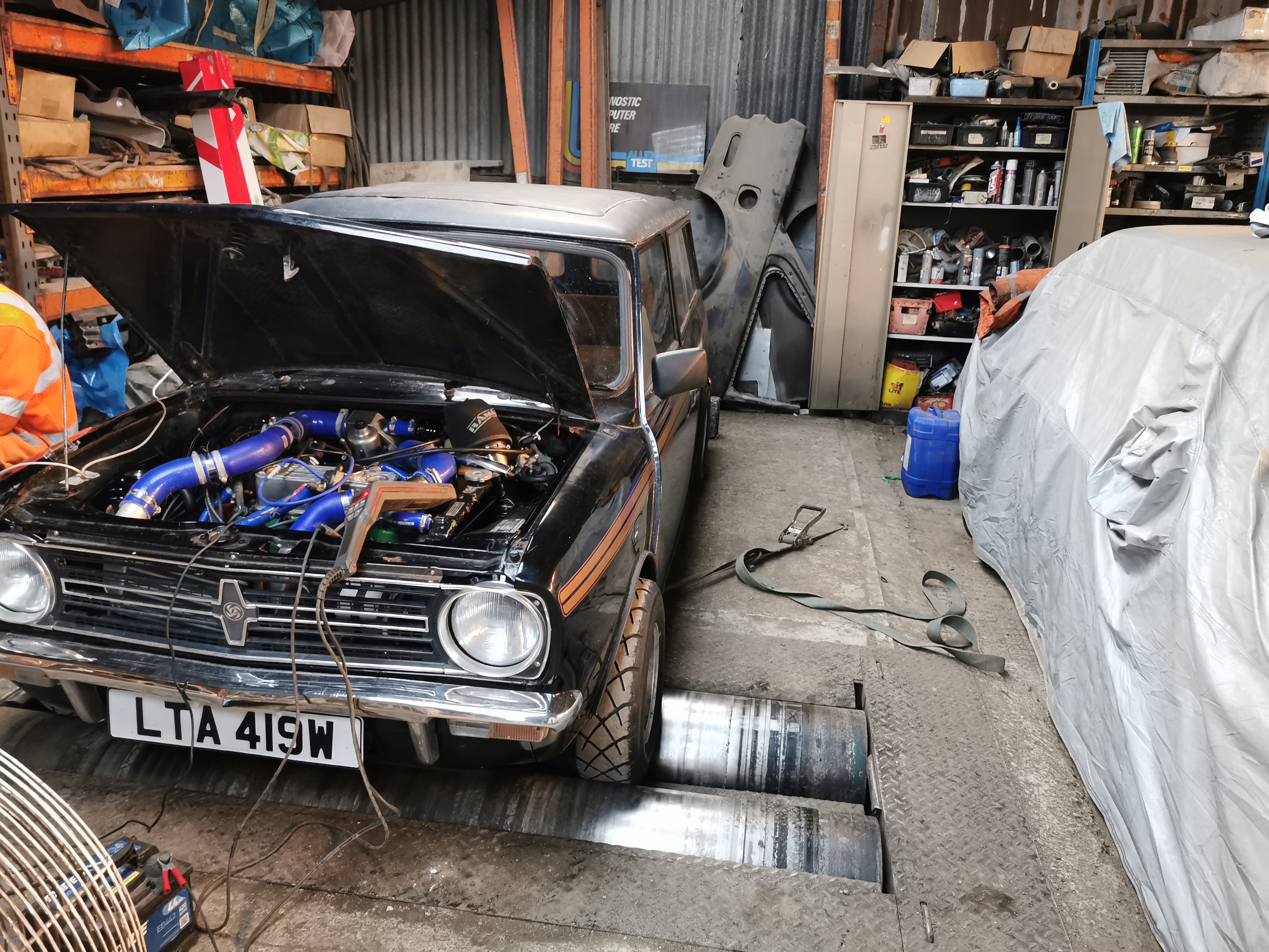

Took the car to the rolling road today. Got the car on the rollers. Mike checked the timing and it was 25 degrees out. So this would have to be corrected with the map, but my laptop back light was knackered. We did try and use it but have up and used one of Mike's. The first wouldn't connect then we used another running XP and we could actually see what was going on. He wrote a rough map.
Ran the car up and the clutch was slipping. I thought that was game over! He ran it up again and it was fine so it just need bedding in a little.
My boost gauge over reads he found out as well. Boost peaks at 19psi and settled at 17. Power is 150hp at the flywheel and 130hp at the wheels. We didn't bleed any extra off so I'm guessing my half a hole of pre load is more then I thought!!!
Fuelling is good, I'm just using a BCA needle with SU dash pot oil in the carb. There is room for a little more boost up top as it richens up.
Turbo Phil popped up as well as he's local. I took my kids along as the Mrs was working today, which made things a bit harder but we got there in the end.
I plan to improve a few bits now it's set up but my intention is just to enjoy it and have fun!

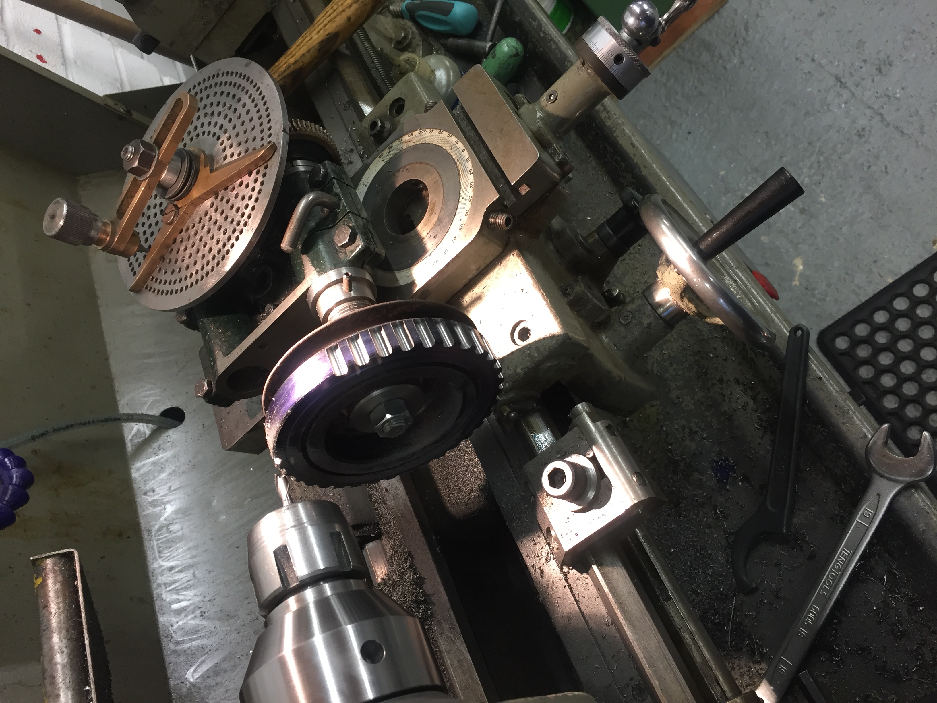

I've been using the mini lately when it's been dry, and today was one of those days. I took my daughter to a party and on the way back after a bit of boost *bang bang bang* out the back of the exhaust. I thought its never done that before then the car cut out. Pulled into a lay by and the car would turn over but not fire.
I think the trigger wheel has slipped again! This is after using thread lock. I was already in the process of sourcing another bottom pulley so I can get one of Tom Fentons machined pulleys and sensor brackets. Also I'll fit a different bolt to the Allen headed one fitted now.
shane
2646 Posts
Member #: 1246
Lowestoft, Suffolk.
If you have one of the pulleys with a large damper on I can machine the trigger pattern to it.

Thank you, I've spoken to Tom Fenton about doing one with his bracket. Just waiting on mine to arrive. I bought another off ebay, minispares are out of stock on new ones.

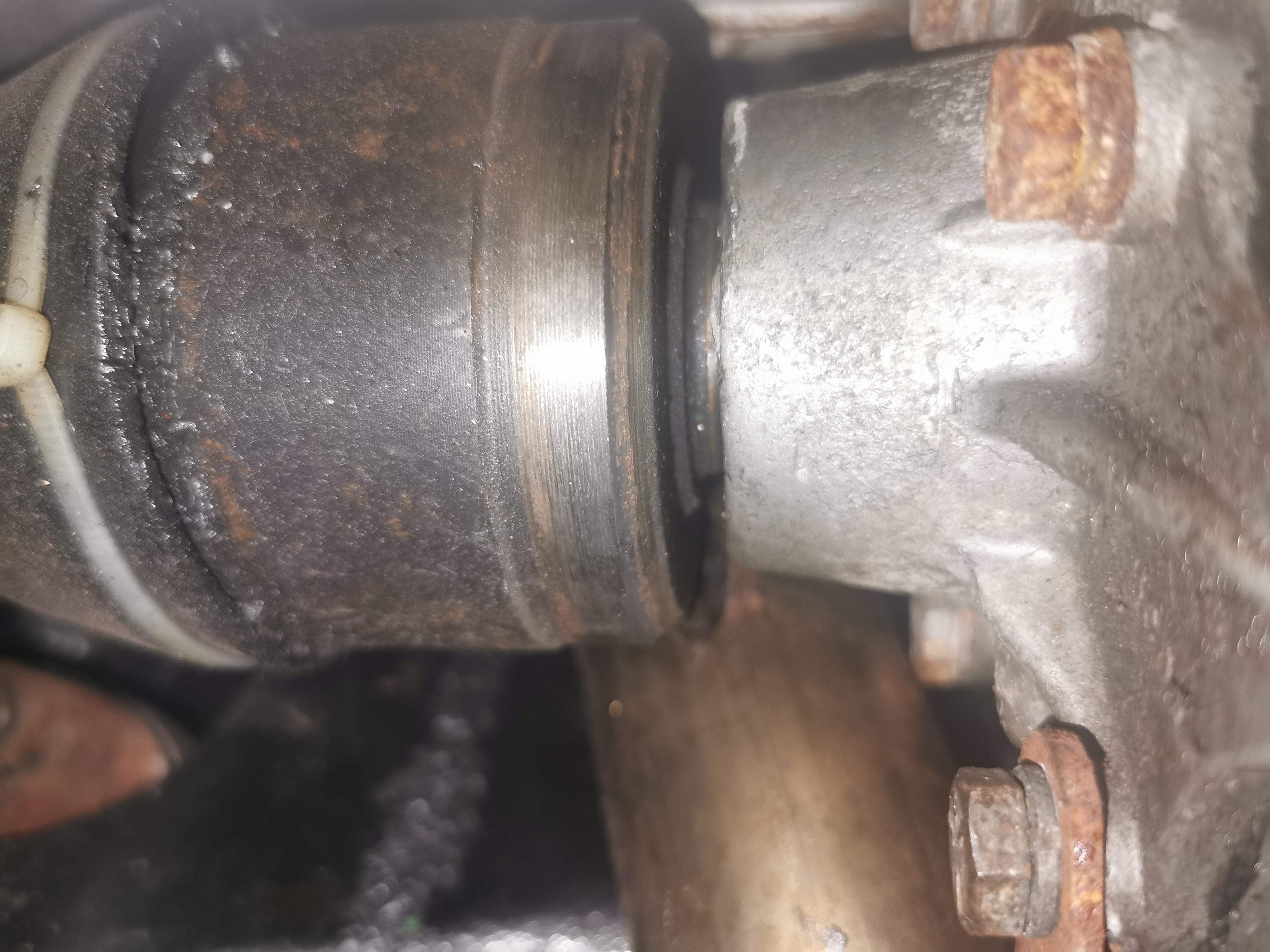

A friend at work noticed the downpipe was touching the pot joint. This must have been from changing the pulley because I had the engine steady off. You csn see where it was rubbing, luckily it hasn't blown a hole in it
e5tus
428 Posts
Member #: 10128
Dorset
Mine did the same, the back box fixed locations were pushing the system forward slightly, needed to trim the length of link pipe and used a better slip joint fixing after downpipe. Had formed a decent little radius!
