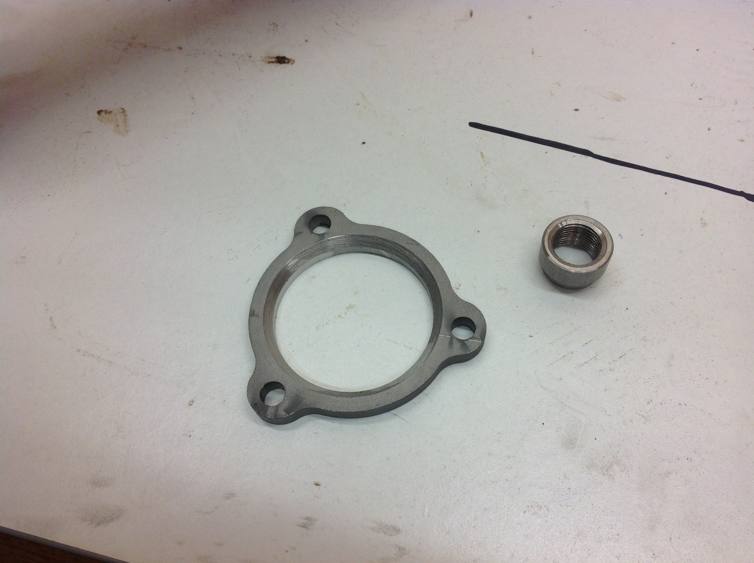

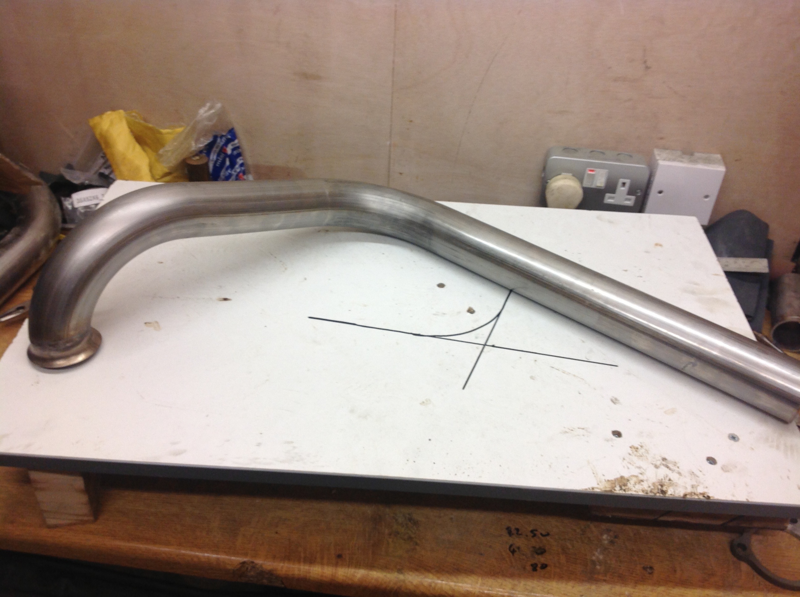

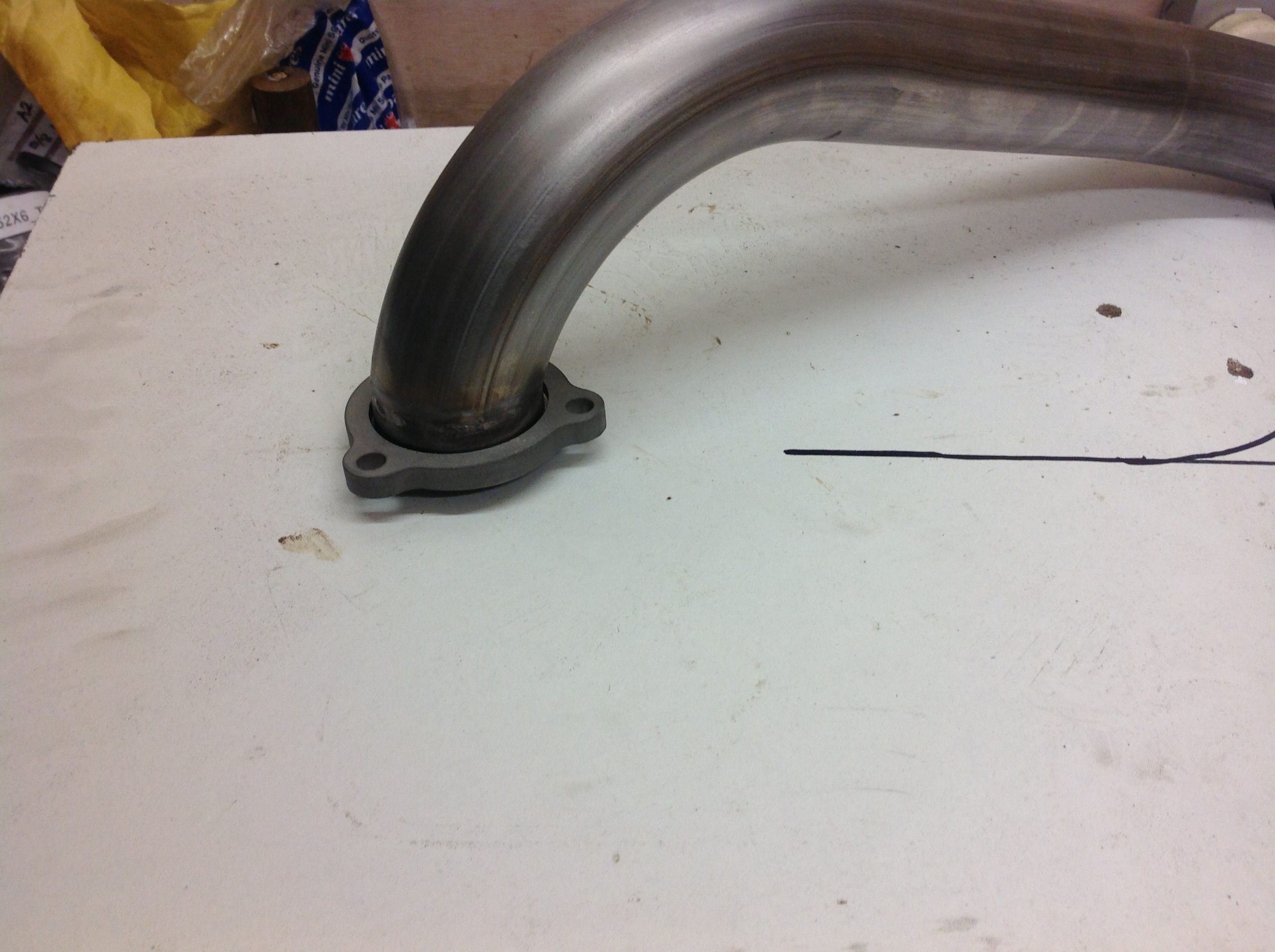

Nick, the downpipes are £150. The first one is now complete, apart from finding out if where Hazpalmer wants his lambda boss. Due to many people using different size centre sections I can supply them with either a reducer to 2" or 1 3/4" which will be welded onto the downpipe ready for a clamp joint to centre section.
Pics...to follow when my photobucket starts working! As I can't work out how to do IMG codes on my iPad I've just attached them. Lol
