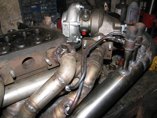

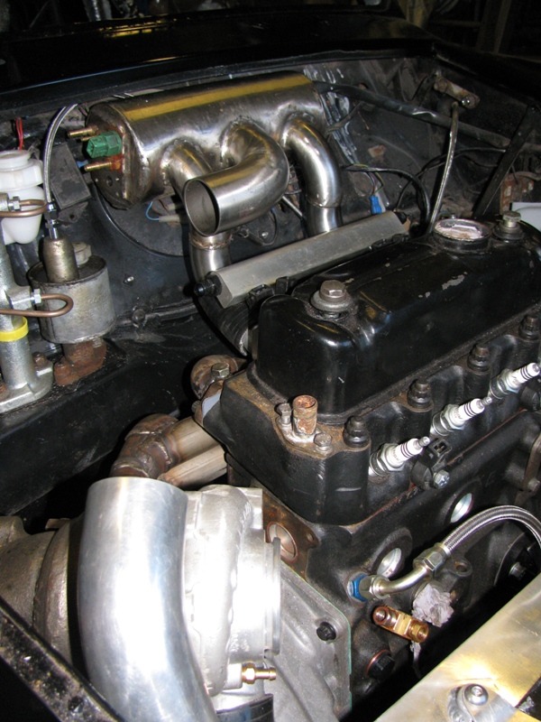

Finished of the manifold and downpipe this afternoon with the addition of the sample pipes. Also drilled and tapped the manifold at the flange for EGT thermocouples or alternative sample points:

Did you get the manifold bends anywhere local? Going to be getting some soon to make a manifold for my Kseries turbo project, and as I'm still a novice when it comes to Tig I may need some bits to practice on.
P3sk3tt
21 Posts
Member #: 10566
The elbows were from here:
http://www.allstainlessltd.co.uk/products....bfitt_elbow.gif

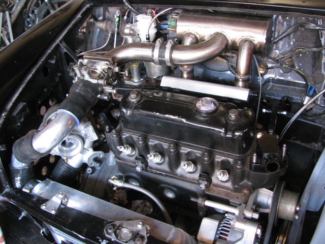

Working on the inlet today. Yes, it's the old one with new injector bosses *smiley*
Trial fit of the throttle body. Second attempt as the first ran diagonally across the top of the turbo but too close to the heat for my liking.
The square headed plug on the TB is where the water injection nozzle is going, but that's not going to clear the bonnet, so I need to drop the TB a bit.
I'm going to take the loom inside the car otherwise I'm not going to have access to the fuse box, plus it will make a tidier job. Anyone else done this?

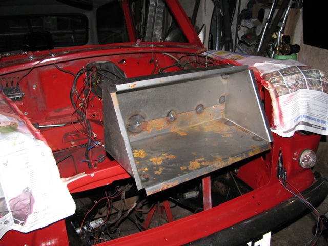

In other news, a plenum air box!
Should have de-rusted the old bit of steel I used, but that should do *smiley*
