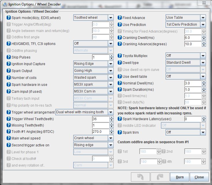

have a look in the tooth logger to confirm there are separate traces for both the crank sensor and cam sensor.
Have you configured for dual wheel mode in Ignition Options and selected the right input? Assume you're using the MS3X cam input?
If the Lost Sync Count is only 1, then there is not a lot wrong.
It's a good idea to turn on Noise Filtering.

Good news :)) Today I started out by tweeking a bit the ignition configuration and also changed the spark output from A and C to A and B.

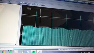

These are the crank and cam signal

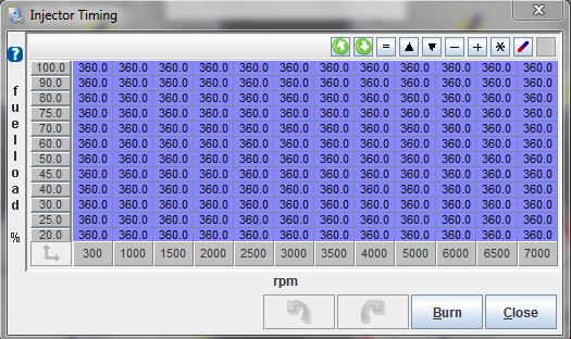

Regarding ignition timing I have used channels A and B and set as per attachment. However I have not yet altered much in the ignition table.
Edited by Barrieri on 28th Mar, 2016.
Barrieri
307 Posts
Member #: 11231
Oh sorry you meant injection timing, I misread it. To be honest I'm not very sure of what it is all about. Currently the table is as per attachment.

On 28th Mar, 2016 Barrieri said:
Do you think I should vary the injection table to account for the tip-in problem ?
No, Tip-in is a separate issue.
To be honest, you need to stop at this point and do some reading and understand the fundemental problems of injecting a siamese port engine.
On the A-Series, the holy grail is getting enough fuel into the outer cylinders. This can be done by injecting through the inlet valve when it is open. Hence the injection event needs to ocurr at a specific point of the engine cycle.
Have a read of this:
http://jbperf.com/sequential/Fuel_Injectin...e_A_Series.html

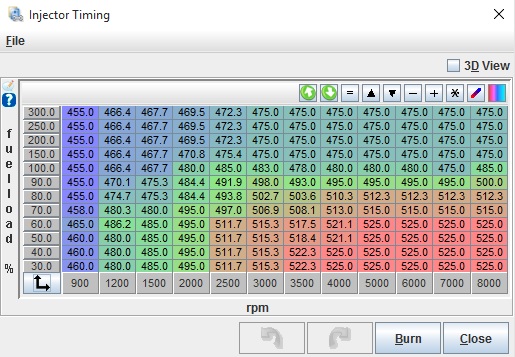

In the meantime, use this table as a guide. This might stop you from damaging the engine:
This is for a 998 using Mpi injectors and manifold, so should be in the right ball-park. It's for a boosted application but the 0 to 100 load figures are proven.

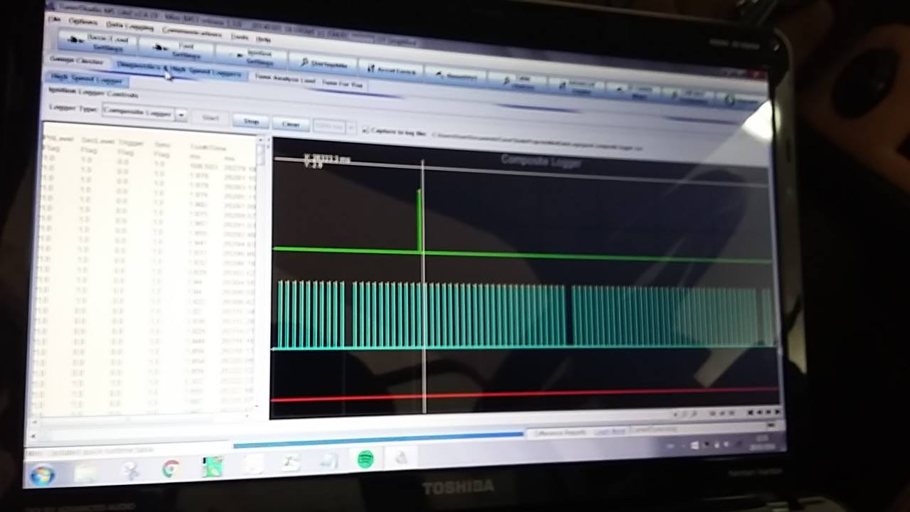

It is set such that the cam sensor is in front of the cam tooth when both valves of piston 1 are closed
Unless they have changed the manual since I set mine up, it used to say cam trigger should be approx 120 BTDC (assuming a crank wheel missing tooth 90 BTDC).
So composite log should look more like this (this is mine).
The cam trigger being three teeth (approx) before the crank missing tooth, obviously once every other engine revolution and ideally on No1 compression stroke (to keep the injector wiring in numerical order).

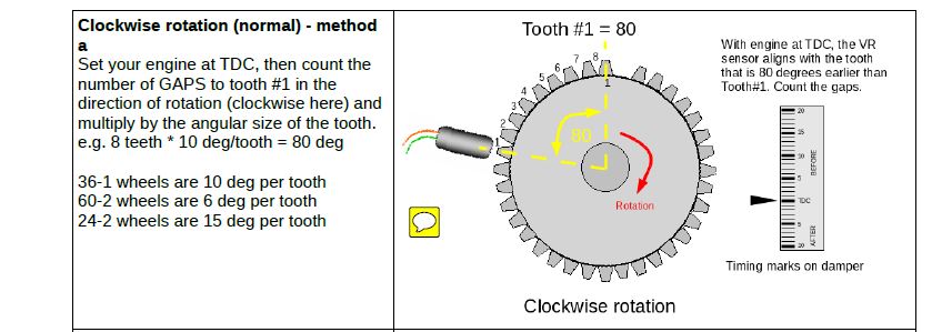

Regarding what you're saying I have a slight misunderstanding I guess... When I was setting my crank trigger wheel which is a 36-1, the procedure used was to put the 1st piston in compression TDC and from the first tooth (engine rotating in clockwise) I placed the crank sensor on the 10th tooth (counting anticlockwise). Which implies that there is 90deg from the first tooth to the crank sensor. However when then I was configuring the megasquirt ignition setup, I had to assign 270deg instead of 90deg.
Attached is the procedure adopted
