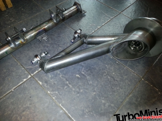

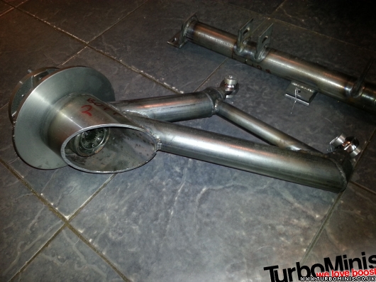

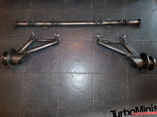

this is how it stood 6 odd months ago
Uncle Carls at force racing built some arms to my specs and also a beam to hang them from
the rest of it i built, the whole rear end including diff weighs less than a standard rear subframe only just though
im going to dig out some pictures showing what it started as, upto how it is now
the main points the design had to include was to mount every part of the rear end from be mounted to the cage as good as if it was one piece and able to be jacked up fast without damage to the diffuser thats yet to be built and to look good, the rear most triangle will be visible once the diffuser is fitted,

Shite the bd that looks cool
strengthening for the top arms / towers
rear arms and beams
Edited by Brett on 5th Jun, 2020.
the start of the rear end
