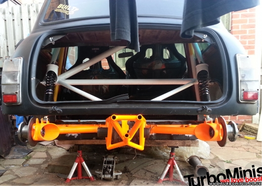

You sneaky bugger! This is looking awesome, I've always fancied a VTEC 4WD Estate/Van/Pickup as a long term build later in life, the speed you've put this together is phenomenal! Awesome *happy*

Scan a little back in this thread when i was talking about rear mounted vtec.i did a photo shop of an engine in the boot and under the car is the rear diff lol
The covering random stuff with matts
The whole gearbox tbh its the only one i know of with the starter where it is
The fact i mocked up with a b20 non vtec.. only ever fitted to crvs
The selective angles i used in pictures of the rear arms ( way back in the thread ) a few got suspicious then
Just various bits and bobs :)
Someone pointed out via pm that i had a force racing beam and arms custom made but had posted no pictures of it all fitted
Looking at the back of your diff carrier, the ends of the tubes are open. Is that for the parachute?

bit more of an update, been sorting out wires and ecu stuff no pics though boring, boring lol
i think i might of said that the coolant pluming was temporary only so i could get a test fire on it
well anyway i got round to moving the radiator inlets and outlets

a lot better look

Very neat
Nothing gets past Dave lol
How many turns of the steering wheel lock to lock?...... One?.... You do realise that there are corners on the pit return roads!...
its a good job it turns lock to lock then, the tyres just rub the tie bars at full lock
its got more clearance than when it had 13x7s on
Was the silencer just so you don't piss the neighbours off? *hehe!*
