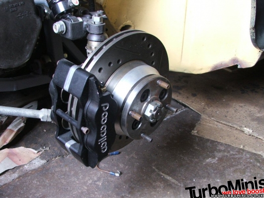

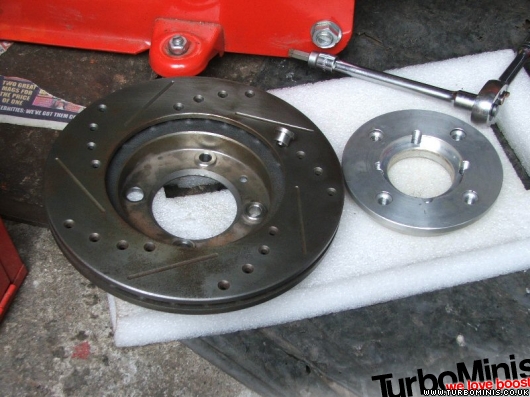

soo today after being snowed off from welding, i have read up on every big break thread i could find.
after Colin pointed me down one path i was hooked into finding a great and cheap solution
so far this method i spotted over on 16vmini is the one i like the most, a pair of adapters should be easy enough
Edited by Brett on 22nd Jan, 2015.

What you need to consider Brett is the cost of a pair of OEM discs against the cost of Wilwood rotors. You need an adapter eithe way so its just a choice of disc. I looked at the cost of the Wilwood rotors and decided it wasnt worth the extra bother trying to sfapt an OEM disc
There are a few options open im just pricing them up and weighing up pros and cons of the 2 main options and then a mix
1: wilwood rotors and calipers 10.2/10.4 inch rotors have been done a few times and with off the shelf wilwood calipers for a very reasonable price
2: landrover 4 pots and maxi discs 9.85 inch this is very nearly a straight fit and 1/3 the price of option 1
Mintex1144 compound pads are available too..
3: 3rd option is oem discs of some sort and calipers of some sort with adapters (there are loads and loads of options for calipers)
I think option 2 will be lighter and up to the job

Aren't landrover 4 pots crazy heavy?
4309 Posts
my thoughts too. anything from a Land Rover is!
Fuck off Land Rover 4 pots. You cannot build a car like swiss cheese to lighten it then bolt those fucking monstrosities on it.
Save up and buy a lightweight alloy 4 pot.
Lol!
I'm with Tom. A nice set of off-the-shelf standard fir alloy 4-pots and a decent set of disks and pads will do the trick.
Whether you need vented or solid disks will depend on the weight of the car and what you're planning on using it for.
