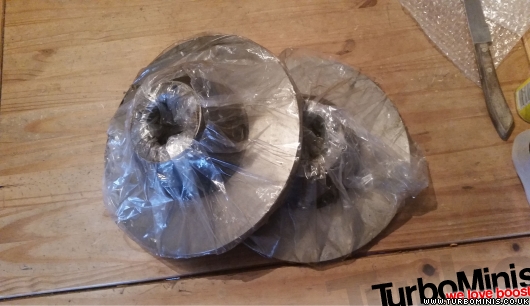

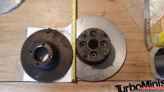

i have just purchased a pair of austin princess discs, straight bolt on to mini hubs 270mm (10.8inch) solid ( i figure they will never do repeated high speed stops)
the discs sit very slightly further away from the drive flange than the mini discs
once these are delivered i will get them mocked up

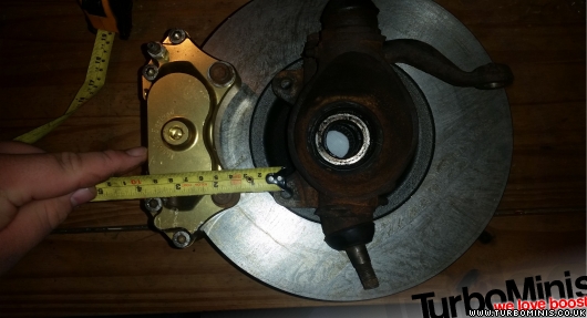

caliper wise the options are wide open now ,, i want to see how my current 4 pots fit first of all but i dont think i will be able to get them close enough to the disc

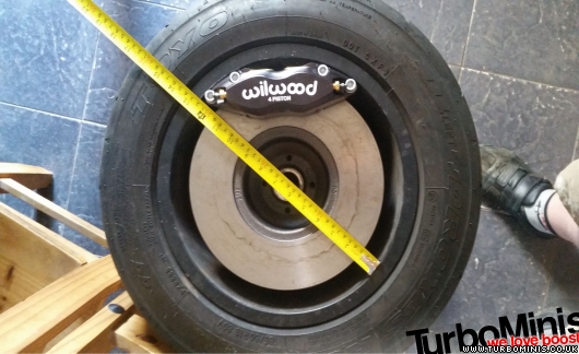

i have 12.5 inch worth of room max inside the wheel, so lets call it 12 inch to give 1/4 inch clearance

Discs finally turned up,
shown next to a new old stock 8.4 *happy*
standard mini flange, straight fit

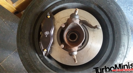

now with this disc the measurement from drive flange to disc centre is slightly larger than the standard mini ( not measured it yet but i will be doing ( bellow) )
what this does is move the disc centre line away from the flange / closer to the hub

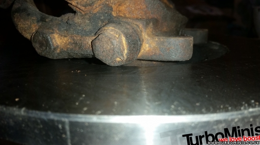

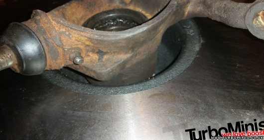

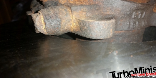

the disc just touches on the lower caliper mounts and the steering arm, both by the smallest amount, so no drama
13mm wider, from flange to the back side of the disc
Edited by Brett on 29th Jan, 2015.
and a picture of the 7.9inch caliper
looks tiny now

im just waiting to pull a wheel off the car and measure up,
first link should fit no problem,
second link caliper is larger and may fit

I am using the midilights, they fit well under 13's with 10.25" discs
this is good to know i have something like 12.5 inch to play with and a 10.624" disc
i cba to pull a wheel off right now for more accurate measurements lol
The Maxi disc allthough a little smaller in diameter to the princess disc, sits further away from the hub, IE its not as tall As the Mini disc.

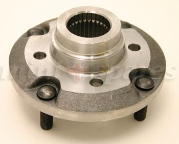

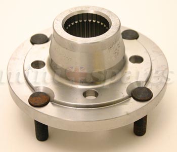

im also thinking metro flanges, dont these move the disc out slightly aswell as the wheel, i havent got any to measure but iirc its 1/4 inch for the flange, does it move the disc by the same abount?
mini flange
metro / turbo flange
i'm using the 38.1's with a cooper S master, the pedal was a bit low till the pads bedded in but now theyre fine.
slater
1030 Posts
Member #: 1291
Suffolk / Birmingham
Yeh the metro flange moves the disc out atleast 1/4"

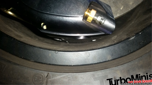

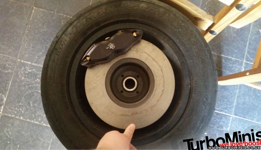

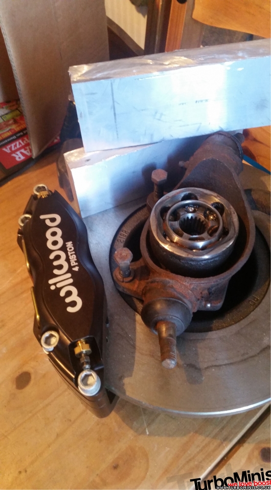

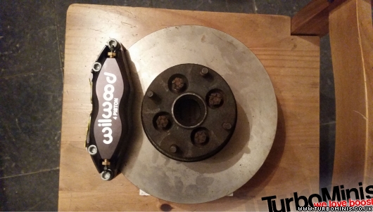

i have had a wheel off and offered it all up to measure up, here is a couple pics
almost made to measure *happy*

bit of an update,
blocks of ally cut ready to make the caliper mounts

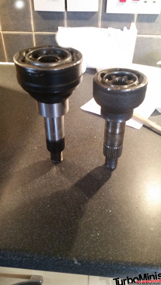

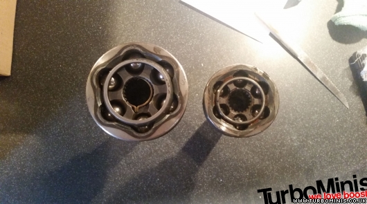

new Heavy Duty CVs *happy*
