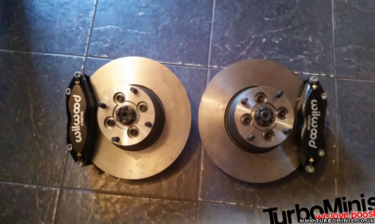

ended up buying 2 new metro sized flanges to move the disc away from the hub,
i figured since the flanges have a built in bearing surface and are only £35 a side, new ones would be beneficial

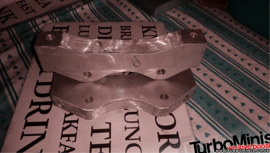

a nice bit of CAD for the caliper mounts

Small update for now, calipers should be mounted by the end of the day
Disc..................5.465kg!!!!!!
Flange...............1.285kg
Bolts x4 ............82g
Hub...................2.865kg built
Caliper...............2.045kg
Mounts..............500g each
Mount bolts........100.8g
12.342kg per built hub..*surprised**surprised*
7.9 caliper....1.670
7.9 disc vent disc inc flange...4.615
7.9 vent disc..3.330
Weight of 7.9 inch settup...9.150kg
8.4inch disc...2.880kg
I will also weigh what comes off with the 7.9 kit and the 8.4 settup for comparison

well there on, the mounts are essentially done, however a nice bit of shaving and some speed holes wont go amis
it took 5 hours to drill those 8 holes !! measure 10k times, drill once..
