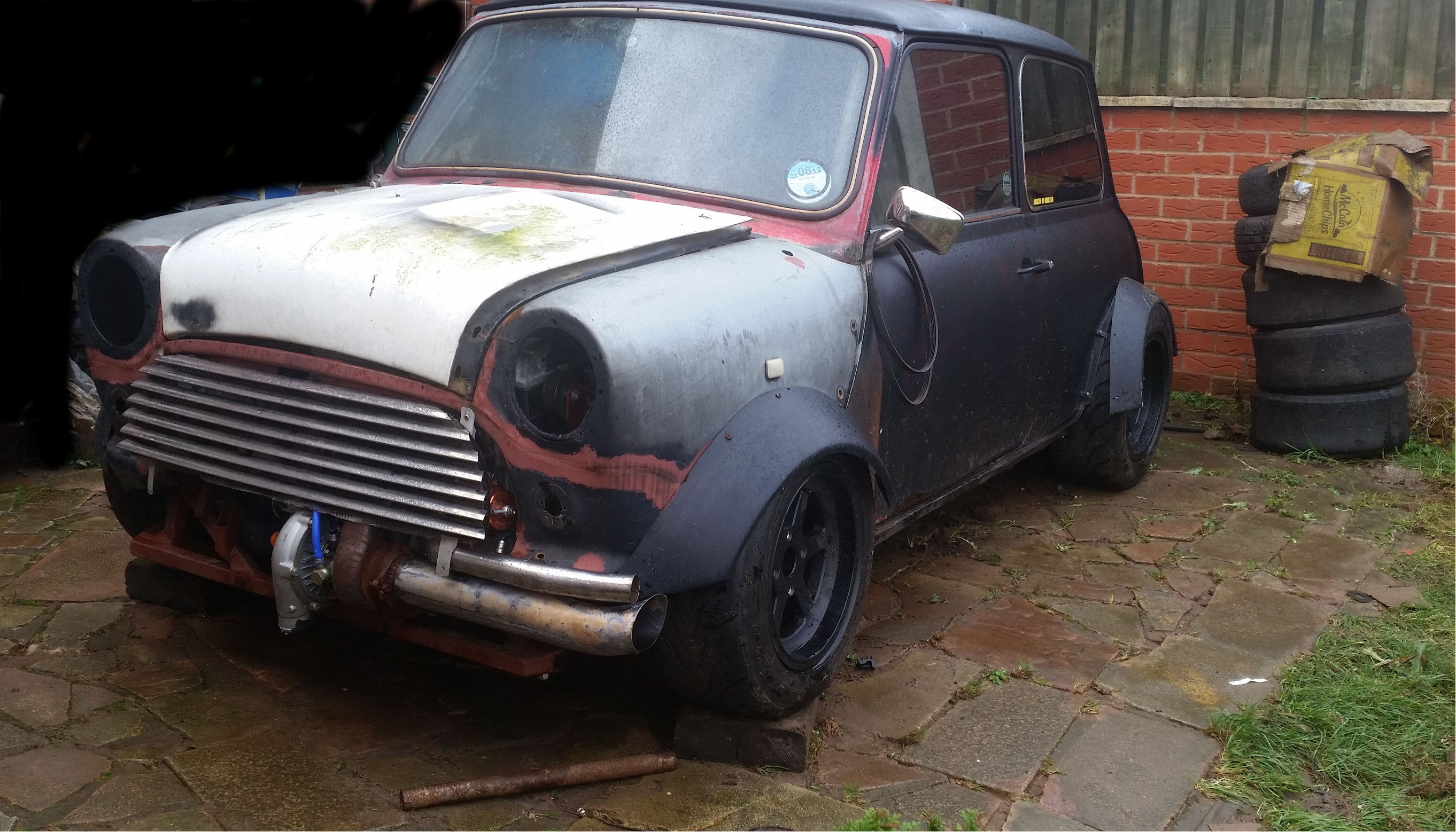

if i go clubby i will definitely build a new manifold, it would be the only reason for the clubman front, i want to keep it round nose for the reason Dave said afew posts back,
i have done quite a few things building this that i have not seen done before, when i set out i was told by a few you cannot get a b series vtec in a standard lenght front...
yeah well fuck them because i got a transfer box and cable shift in there too..
if i had gone for a 'normal' sized turbo it would sit nicely infront of the radiator.. however a 50lbmin-1 turbo is not small, even with this i may want a bigger turbo in the long run,
infact i want to pull this gt30 off and fit a holset hx35/40
im confident i can cover the turbo as it sits now, the only problem is going to be for the road
i could do alot of things, that gt30 is getting spyed up for the skyline though

Hmm. That looks like it will set fire to swathes of hedgerow.. as well as the occasional pedestrian.
How much extra room do you have if you bring the turbo flange up to the bottom of the head flanges? Looks like you could tuck it back another inch is so? And possibly get the downpipe exiting behind the front panel left hand indicator.
That's essentially what I did with mine, it was close to 50mm saved compared to being lower down the block. It also helped with keeping the turbo oil return above oil level in the sump.
There is space there that can be used but the dipstick lug and pipe sits behind the exhaust turbine, also the subframe would be in the way of any down pipes, the indicators were removed because the housings fouled on the subframe( to give exam0le of how little pace there is)
