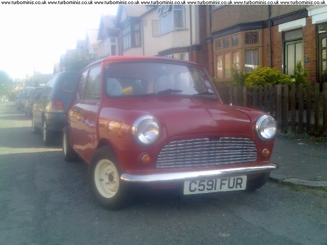

thats pretty cool, i like its archlessness
get some black no plates for it though

i think the cage and 295 head are my 1st port of call, black No' plates are a maybe, i had them on a previous car, i think some lowering to level the suspension arms/driveshafts at the front is in order and the back lowered to match, its a bit dented and paint-chipped but is rust free, i thinks chrome lip-trim is needed too! i like the minimalist look really, but a turbo on the 998 would be ideal as a fast road car i think!!!! i'll add pics of my jobs i do & things i change on the car etc etc my rolling project that all jobs have to be sorted on to keep it on the road for the week hehe *tongue*
i'm glad you like the look i'm aiming for guys!!! cheers

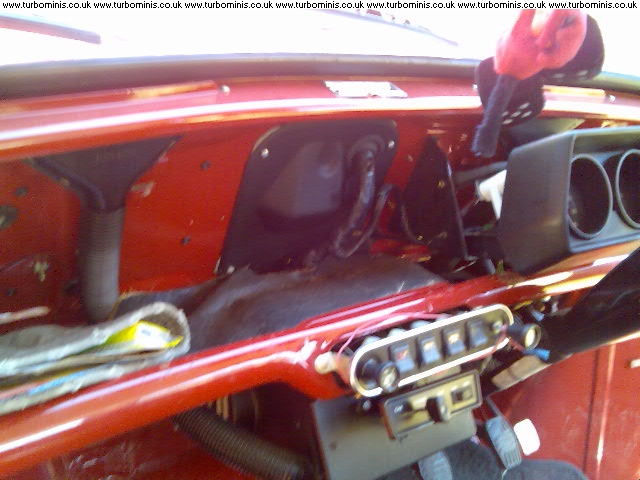

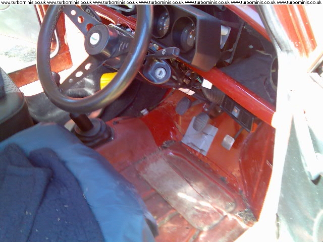

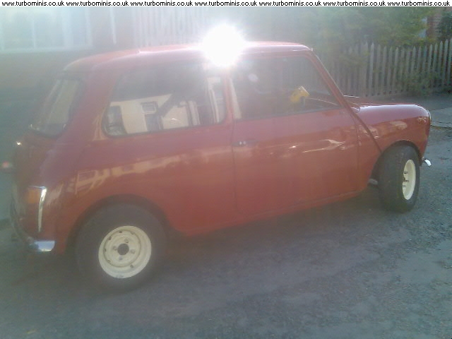

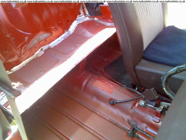

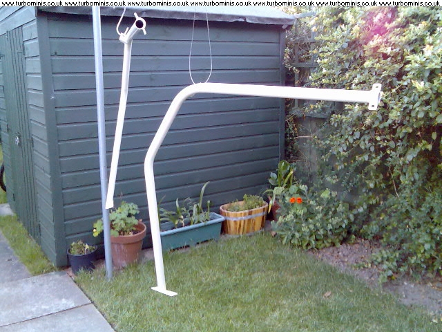

Added some pics, i've stripped my interiour but left the doorcards & speedo! excuse the seats *oh well* they are blummin awfull, they dont even recline
christ its loud with no sound proofing!!! why did'nt someone say haha *tongue*!!!

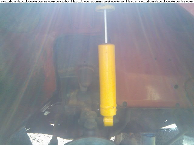

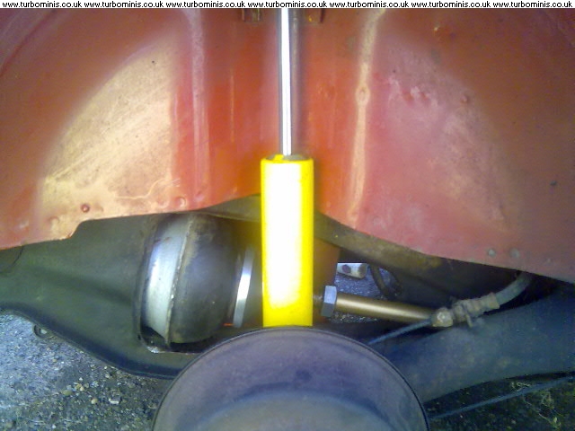

Fitted these 'ex-JF' spax shocks (how long since i got these from you john hehe!) and they're fine!!!
Fitted my rear hi-low's, fronts are going on at the weekend (standard height at the moment) *frown*
As you can tell, i really like waxoil, used 2.5 litres, got 5 litres to add!!! & i will 'trust me' *laughing* we dont like rust much *tongue*

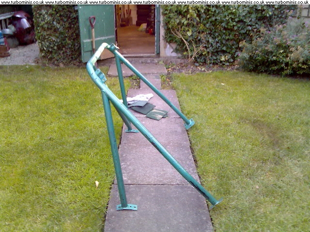

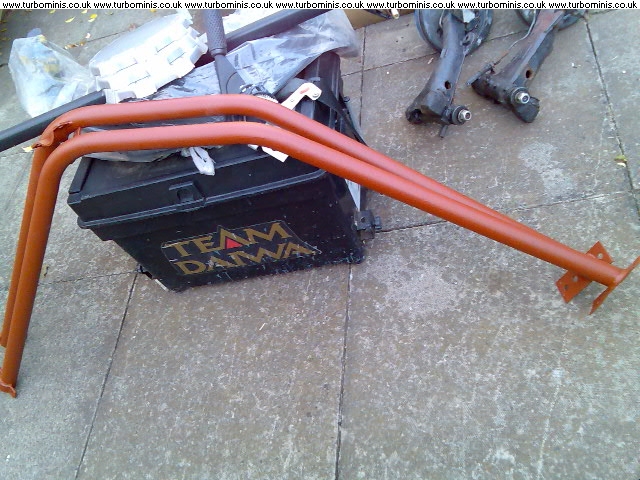

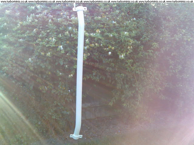

cheers for the rollcage 'wetshed' *happy* its going to be prepped & painted this weekend & maybe fitted (will add pics of painting & fitting)

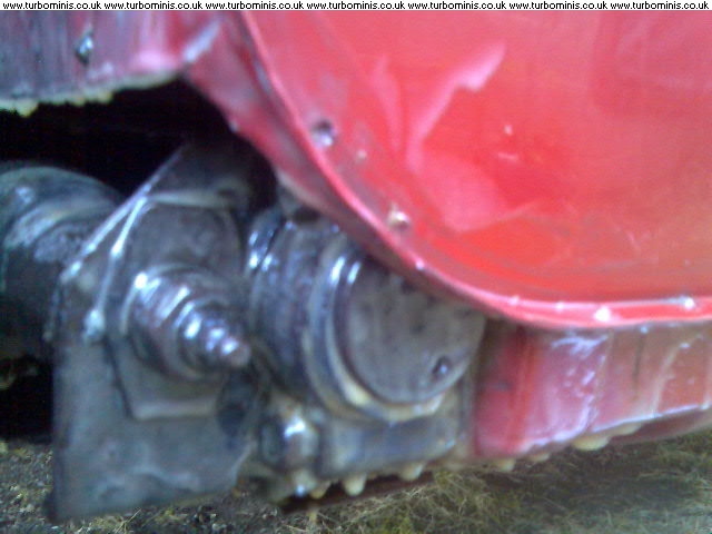

got solid mounts for the 'front subframe rear mounts' (to the toeboard) and solid tower & teardrop bushes, pics of the proccess i go through with these i'll add to!
i have camber brackets for the rear subby & heavy duty adjustible tiebars with poly bushes for the front, still need 1.5 degree negative-camber bottom arms, it's gettin there tho, any suggestions PM me, cheers *wink*

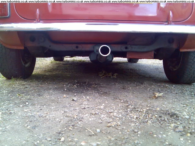

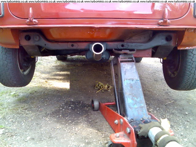

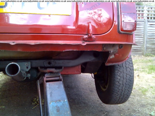

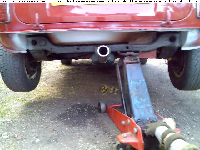

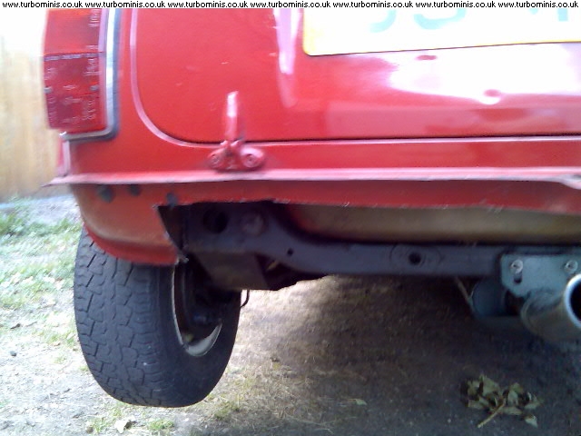

been to ask my local MOT man about removing my rear valance & he's gave the ok on the removal of the centre part, he's said leave the rear valance closing panals at either end to act as mud guards (sort-of) but the flappy central part i can cut off & bin-it! *happy*

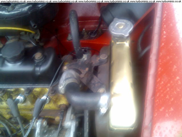

heater valve new one fitted
6 point cage solid rear diagnal, prepping and paint to match my wheels (cheers wetshed)

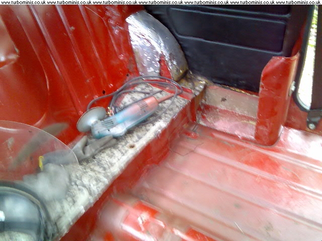

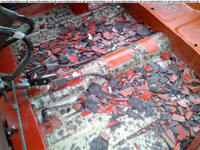

cutting the rear sear squab off & starting to remove the sound deadening from the floor, i will remove the rear pockets too, but have no harness's yet!
i'll repaint the inside of the car after, then the cage will go in *happy*

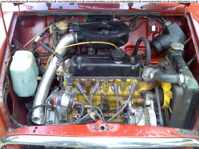

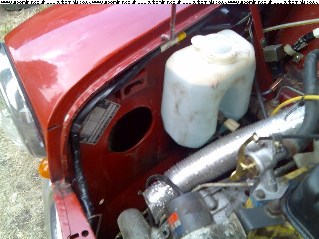

made a cheapo ducting pipe fit my 'keith calver' drilled airbox haha!
removed all un-needed plastic pipes from the engine bay & under the front wings & gave the undersides of the wings a 2nd coat of clear waxoil!!! 'yep even more'!!!

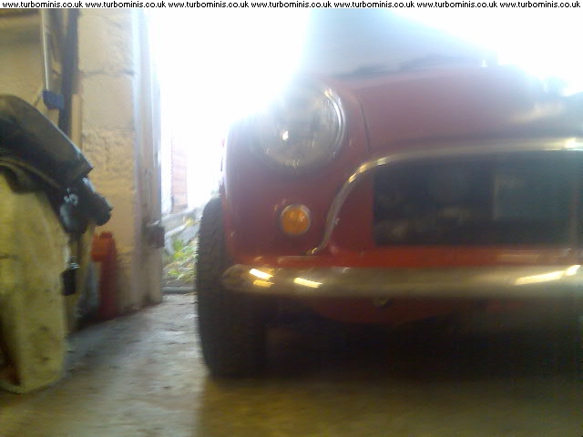

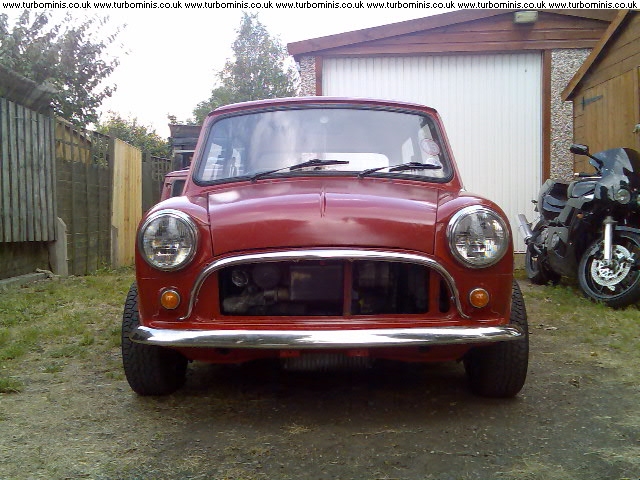

gone for the grill'less look to help cooling in this weather, i think it looks pretty good???

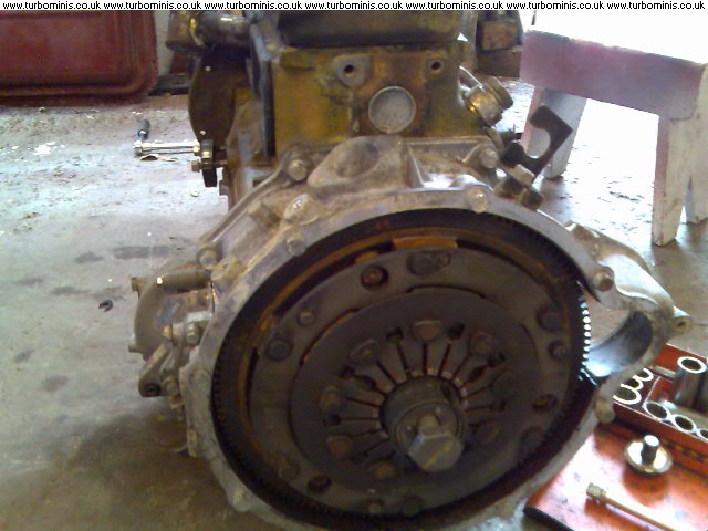

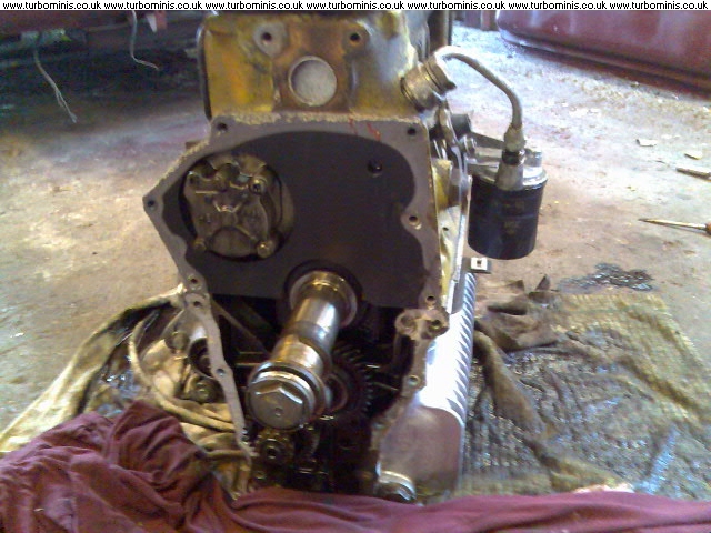

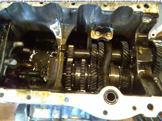

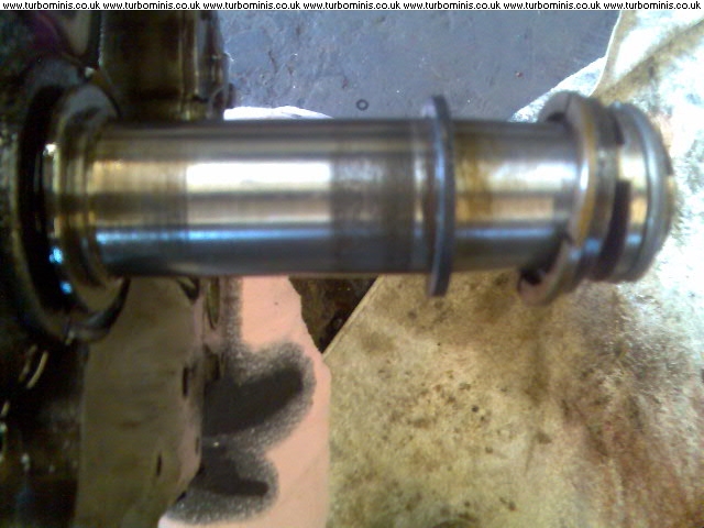

possible reason for gearbox whine?:)

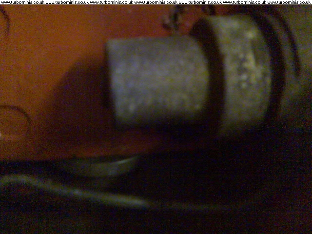

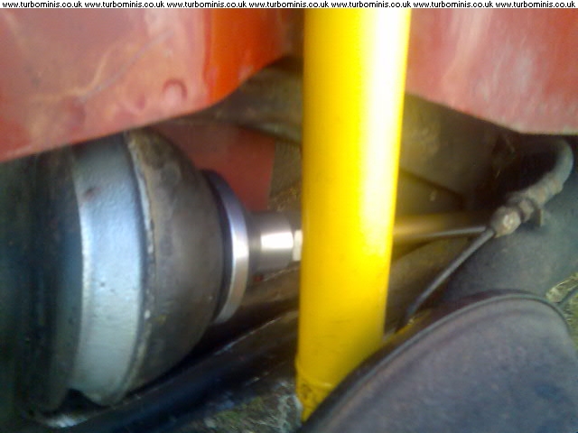

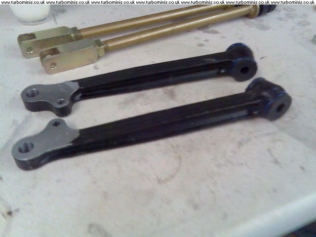

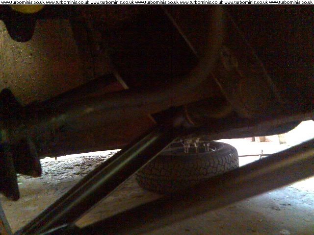

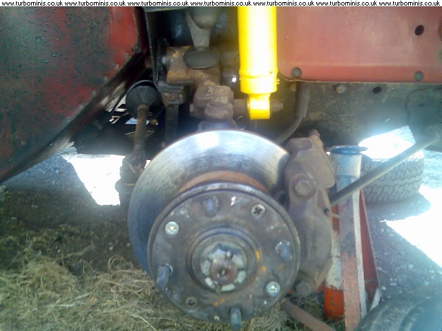

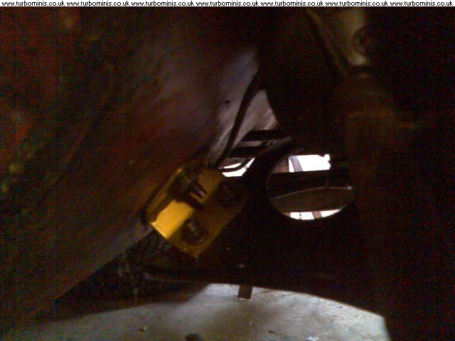

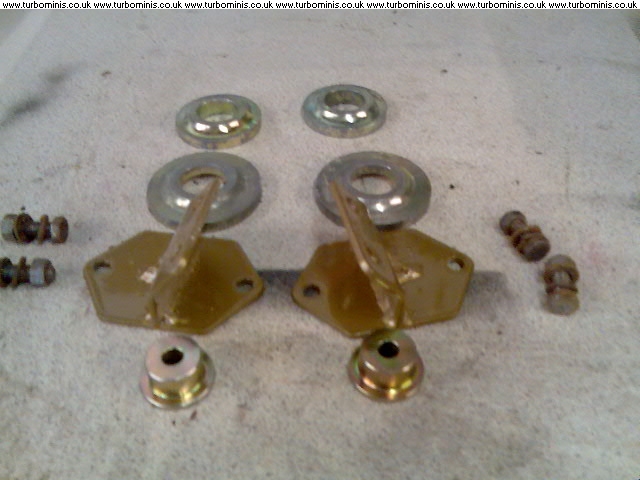

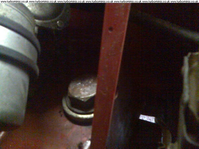

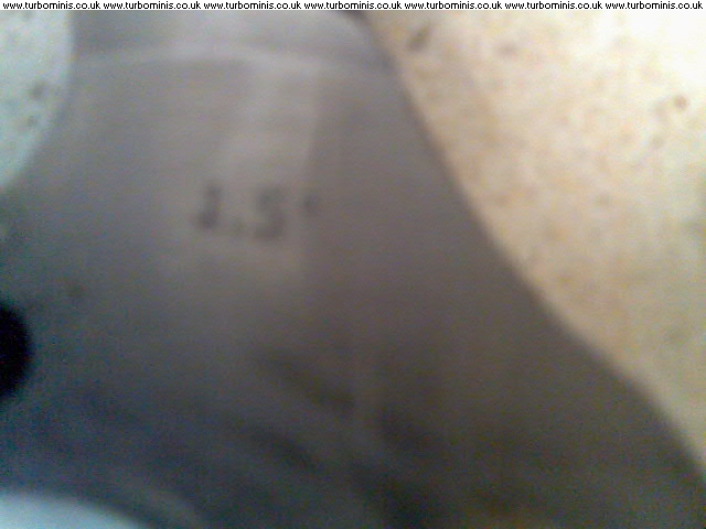

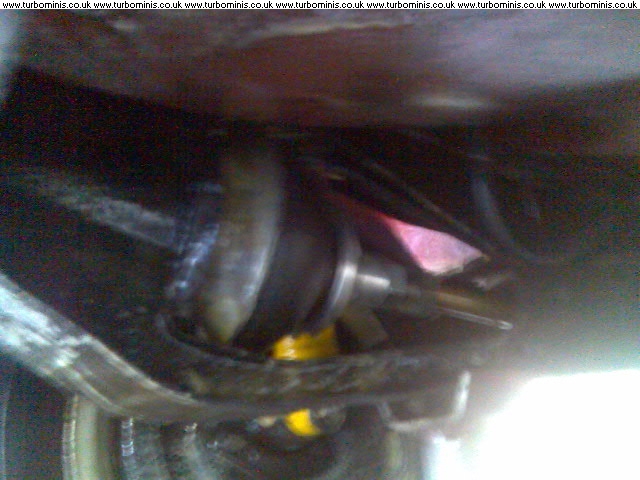

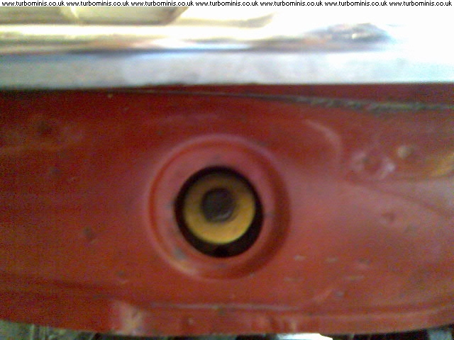

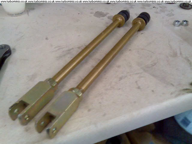

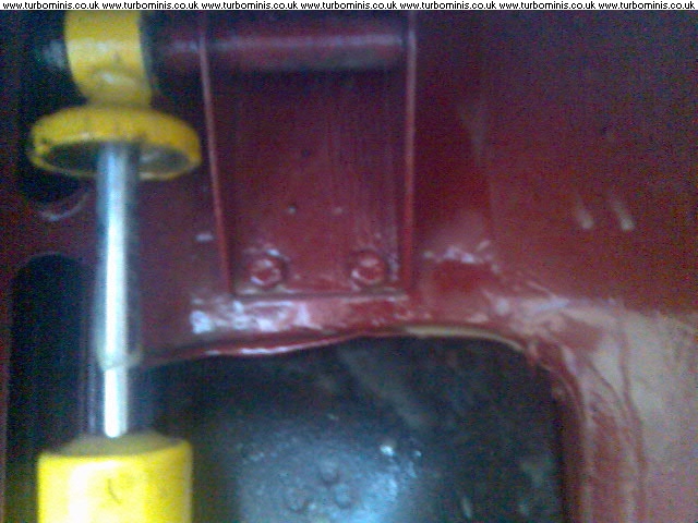

Another good weekend on the car!!! completed solid mounting the front subframe (see pictures) 1.5 degree negative camber bottom arms with hard poly bushes,
i was going to fit my heavy duty adjustible tie-bars but i buggered-up the thread where it mounts to the subframe (muppet) it should rethread ok though (i hope)
as a get-me-by i've polybushed the standard tie-bars, poly bushed the gearbox steady bar also,
i wanted to do the engine steadybar bushes to but the buggers wont undo? HELP!!!
well i can only say 'what a massive differance' the solid mounting of the front frame makes 'superb!!! & the -camber bottom arms 'well chuffed' just need feebles motor in my car now *tongue*
Edited by clubminiflip on 31st Jul, 2006.

15300 Posts
Make sure you get your tracking reset, fitting neg camber lower arms will give you loads of toe out, so the tracking needs doing. Otherwise you'll scrub your tyres to nothing within a few hundred miles.
Guess how I know this?

cheers tom (i sort of knew this *oh well* but was'nt 100% if i had to get it checked) trouble is where i live getting the tracking done on 10" wheel minis is a big prob, no-one does it!!! i need to fit my front hi-lows (this week defo) & drop the front a little so will try to sort the handling at the weekend coming up, trying to get all my jobs done before mini-in-the-park (fingers crossed) *tongue*

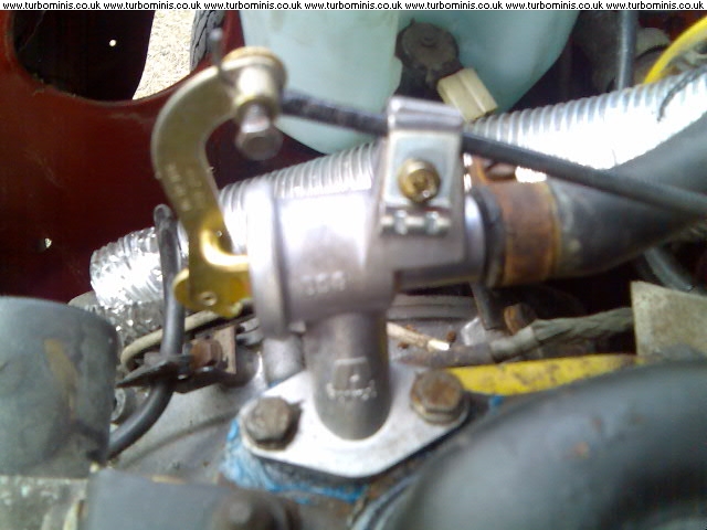

Well done some more work on my lil-mini today,
mini1071s!!! i've added my idea of 'bling'to my engine bay, mmmmmm brass!!! :op

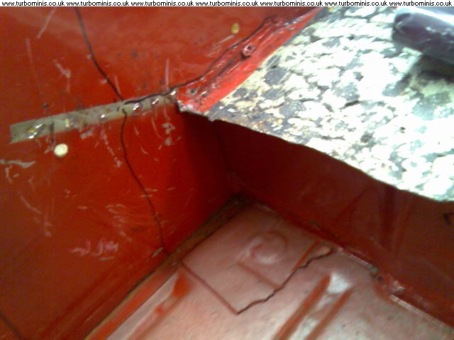

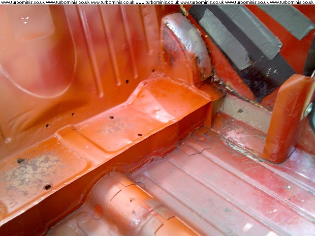

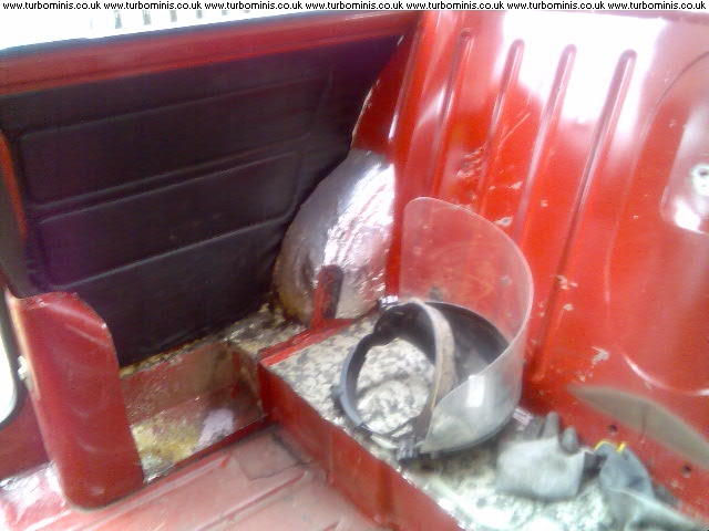

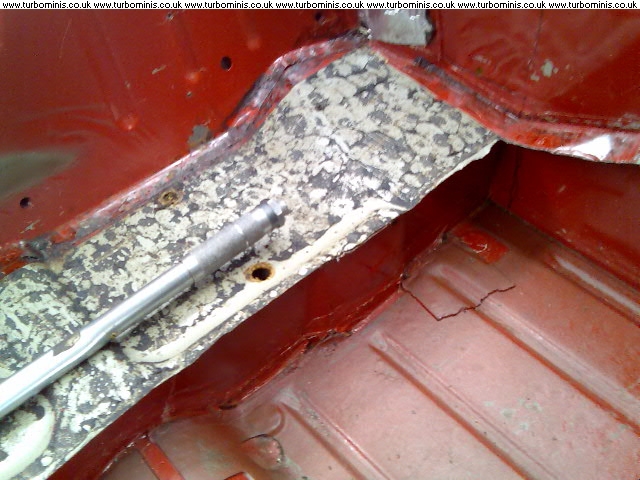

i finished the removal of the rear seat squab & made the edges nice and neat & primed it with red-oxide-primer,

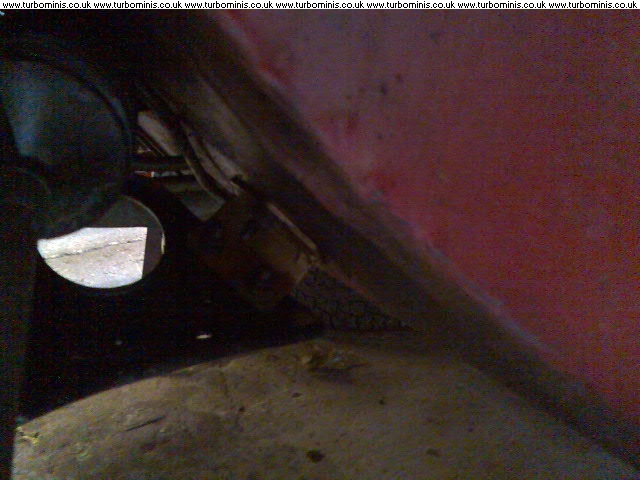

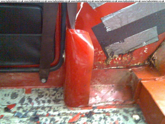

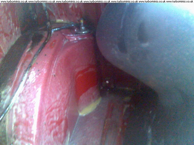

i've part removed the rear pockets (see picture below) because i have 'no' harness's & brown mini city torn seats :o) so they are the temporary setup for the moment!
this is a little dodgy i know!!! but it will get sorted fairly quick, i may weld the seatbelt mounting from the rear pocket to the floor & use the retactable belts untill i get harness's, we'll see tomorrow :o)
i've took all the sound deadening off the rear floor too! this will be cleaned up & red-oxide-primed (how do you get all the black rubbish thats left on the floor from the sound deadening?)
2morrow the centre section of the rear valance is coming off! & the front valance between the mounts below the bumper, it's mini weight-loss!

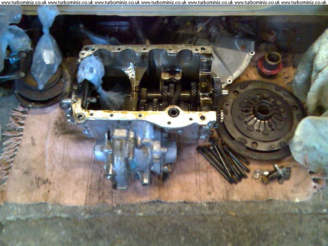

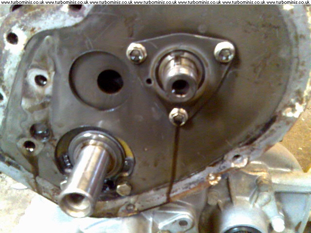

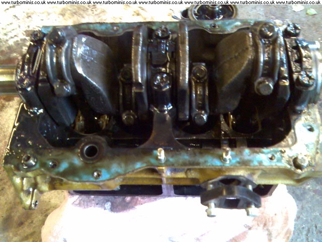

whos is that idler gear (think thats waht it is?) with all the wear? You need a new one ive got spares here
15300 Posts
10 out of 10 for enthusiasm, but please do not drive this car until you have properly sorted the seatbelts.
As it is currently there is now bugger all strength in the seatbelt reel mounting area, in the event of an accident this metalwork would bend and twist and not hold you in place in the seat.
This needs sorting as a priority, please do not underestimate how dangerous this could be.

Tom F it is my 1st priorty tomorow (weds) my solution will be documented in this thread :o) dont want to loose a miniturbo.co.uk member!!! oh & the car!
it not my idler gear/bearing its a guy from norway i think?

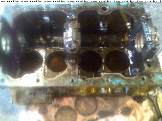

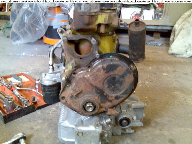

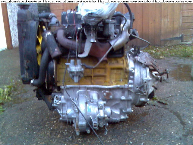

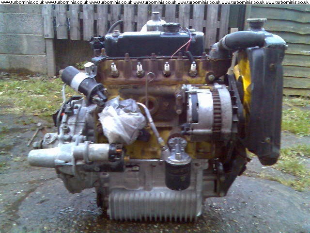

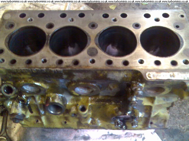

just a short update, got a 998 A+ complete with gearbox & ancilleries today that came from a running car (pics below) not sure on the gearbox untill i strip it but i have a motor to strip & rebuild into a turbo 998+, i'll add pics as & when, i'll be asking mundane & bugging questions once i start on the engine as its my 1st engine i've ever stripped & rebuilt so i'm quite nervous about it really!!! i'm really enthused about it WISH ME LUCK GUYS :o)

next job on my list was to remove the flappy centre section of the rear valance, tidy the edges & prime it, which i think fits my MOD style,oldschool,retro,minimal, racer theme for the car (pics below) the front valance between the mounts on the front panal below the bumper are nxt to go

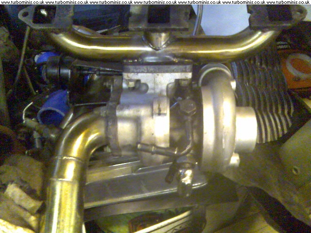

Also i have in my posession a mirage manifold kit with other bits & bobs ('ex-feebleuk' cheers m8y) so i now have 95% of the bits needed to make a 998 turbo motor, so i can start saving again haha! :op Any input always appreciated!!! cheers all!

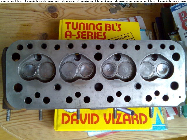

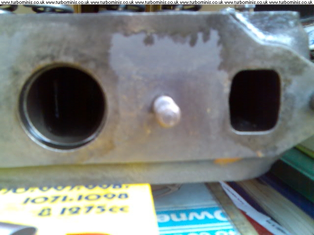

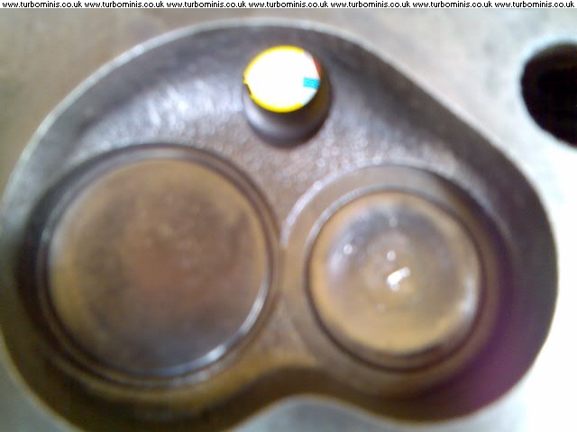

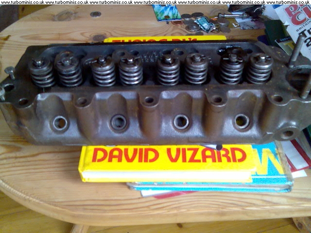

i got a decent & standard (i hope) 12g295 head for the 998 turbo project, cleaned it up some pics below:

i have'nt updated for a little while so heres whats happening guys, well i've took my 998 A+ to piece's with the help of my haynes manual & the bill sollis how to build a 1380 DVD, i must say as a novice to engine stripping/rebuilding this is a great thing to have, obviously i'm not building a 1380 but all the principles are there in the DVD for an engine recon/rebuild & makes it very simple (HIGHLY RECOMMENDED)
i've been reading through the TMF in the quest for possible 998 turbo builds & still have'nt reached my final spec but i think within 2 months i'll have the machining done & block built so i'll update at each stage of the engine assembly

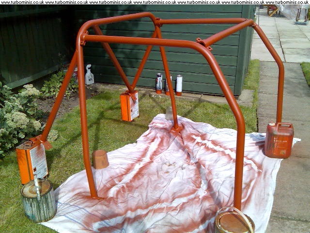

body-wise i've completely removed the rear pockets & fitted some 4-point harness's, nothing fancy just a cheap road MOT-man friendly set

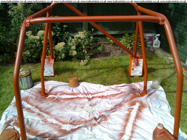

had a change of plan for my roll cage, i'd previously sanded,primed & painted it old english white but really was'nt happy with the finish due to some deep scratch's, my prep was'nt to good so i had the cage shotblasted for £40 & i've primed it all in red-oxide primer, this is how its staying as i really like the colour (some pics of what i've been up to below) advice & comments always welcome
