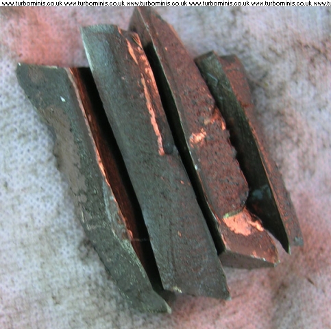

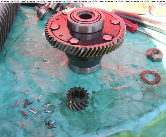

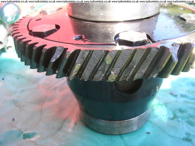

this is done with a 95 hp 98 Nm NA engine! box was totally clean except from crownwheel bits when opened so I dont think any swarf has broke it, must have been a bad one...Norways biggest trackdays are today and tomorrow so it happened at a VERY bad time too*evil**frown*
That's on of the worst I've seen. I'd guess that one broke (which is not uncommon) then this took a couple more and so on.
That's not a broken diff, that's a broken crown wheel :)

ooooh nasty,
the pinion doesn't look too bad though.
was that a machined out std crownwheel or one bought for an lsd?
miniminor63
1849 Posts
Member #: 672
The oversills police
Oslo, Norway

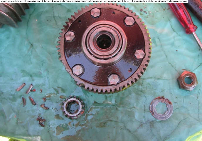

the pinion is fcuked too. both parts in the bin. I bought is second hand, it have been in a box longmanbuilt and used for some laps at goodwood.its 4.33:1. the box (and engine) is back together with a 4.26:1 for now, and the engine is back in the car. not connected yet though. I just lost both the possible trackdays and not a day more :(
