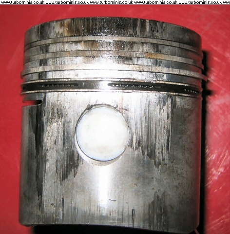

So this is the piston that was obviously buggered and had zero compression for the obvious reason

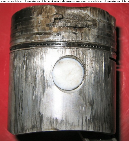

Now here is another piston (the other 3 were in a similar condition of varying condition) this piston still gave good compression readings. It seems almost like the pistons were too tight in the bores; maybe caused by excessive heat?
Any thoughts? Engine is off to see if it can be rebored tomorrow.

the top one looks like nitrous has done its worst , the bott looks like seisure.
so its got to be det! surely.
On 17/07/2006 21:22:17 wil_h said:
the other 3 were in a similar condition of varying condition.
Right as I’ve seen nothing like this before, and I don’t know my arse from my elbow, I’m in the perfect position to comment.
The wear appears to be on the "sides" adjacent to the grudgen pin, as the piston is widest on the skirt parallel to the grudgen I would have expected the pistons to wear there first if the bore clearance is too small, unless the bore is not perfectly round. I presume you’ve checked the bore & piston clearances?
Another possibility is that the clutch is not set up right and is forcing the whole rotating assembly over to the side, have you checked the end float?

Looks like det has taken out the first pictured piston, second one is odd though?

get the bores checked properly with a bore guage, i think sommat funnys up and i have a feeling i've seen it before. I wont go into detail here.
http://www.hadmac.com/piston_%26liner.htm
No N2O, purely boost.
From that link I think it might be a combination of two things - Over heating (owing to it leaning out) and tight bores.
And yst Pete that damage is around the exhaust valve cut out. However, the damage is equal on both sides on all the pistons except the melted one.
It dosen't really make sense though as we are running less boost at a lower CR and same advance as the old engine, which proved bulit-proof.

They had done 3 events and a couple of RR sessions; so maybe 50 or 60 miles. But as I said, I still have the old pistons which are in perfect condition and had done 4 seasons. I don't think it's a piston problem, well it isn't.
i would say that the top piston has got too hot from detonation ,possibly due to lower octane or extreme atmos temp we had at avon ,the first step is it get hot ,starts eating at the strength of the ring lands ,they then nip up and the piston as it rocks in the bore pushes the rings flush with the piston wall,at this point the combusting gases find a new path down past the 3 compression rings ,and out the oil control slots into the crankcase ,then this localised path gradually heats the top till its soft enough to be eaten away ,.
the second picture is a similar scenario ,but earlier on in the process , the heat effects the dimentional stability of the piston and subsequently it gows more across the pin where the mass of ally is greater ,so semi siezing in the bore ,as part of the same process .i have seen this sort of thing a lot in rover v8 engines .
the answer would be run cooler with more octane and poss less timing on boiling hot days ,run richer to keep piston cool ,and possibly increase bore clearance ,but this can raise its own probs if done too much with the trapped mixture between the top ring and the piston top being a possible source of det itself..best to run a correct clearance ,and keep it cooler .

All that sounds like a reasonable expination
We run 101 octane fuel, but I think a fuel filter blockage leaned it out causing the heat and det etc. we could easily retard the ignition a few deg.

Did you have a fuel filter block?
If so that is sure as eggs the cause of det - you ran lean.
Hot air temps doesnt help DET but it does lower the density of the air so you end up running a little richer than usual - that usually helps reduce det!!
On 101 RON fuel it shouldnt have done that just because it was a hot day - you have an IC dont you? Do you know your Air Charge Temps?
How was the ignition mapped? Det cans? Rolling Road?
Alex

The fuel filter was deffinately a restriction, but this has happend on many occasions, for various reasons, and nver resulted in this before.
Yes we have an IC.
And yes it was mapped using Det cans on a RR
Cheers Peter.
What I am finding difficult to understand, as I have already said, is that the old engine running the same advance, fuel and cam timing, but a higher static CR and more boost never had a problem; even in similar temperatures.
Ahh. T2 running 65% T3 running 70%

From the logs taken on the day (not including inlet temp unfortunately, and the O2 sensor is not working either) it only ran 217KPa which is about 17psi, so even the boost was not silly.

something else that may have some relavency is that if you were running the t2 ,instead of the t3 ,your exhaust back pressure could have been higher ,the t2 r5 turbine is 47mm big dia 35.25 small dia,whereas the t3 is58.5 and 48.5 ,so could well create less back pressure ,this creates less exhaust reversion and hence less contamination of the incoming charge with hot exhaust gases, which is deff a detonation encourager!... did you record this bp on the rr compared to the t3 bp,wil?

it seem to be det for me, I think the t2 is on boost earlier, this making the "T3" ignition curve too agressive, making a big difference in events. about exhaust restriction T2 have a smaller turbine wheel , but a larger A/r (0.35 vs 0.25) this meaning that it is in fact more perméable than the T3 (less restricted) .
I think you should recurve your ignition to match the T2 boost curve.
