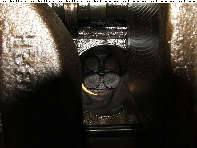

Am producing an 8valve, turbo charged, 998cc version now too. *smiley*
just can`t help myself can i ?
*smiley*
www.miniman.com.au
top stuff matt, keep us posted.
the valves in the 8v head are huge arn't they!
johnK
1425 Posts
Member #: 690
Norfolk
34mm inlets and 30mm exh - but I'll bet the ports flow a lot more air than an iron 5 port with 36*31 sizes.

Standard 998 bore, no chance, 8 or 16 valves.
To get the valves to fit requires lots of machining work and thats been covered.
Still think the 850 block is the one to start from for the small bore, you cant off set the bore enough on the 998 before running out of metal
There are other ways though, and if you cant work it out, im not telling*tongue*
