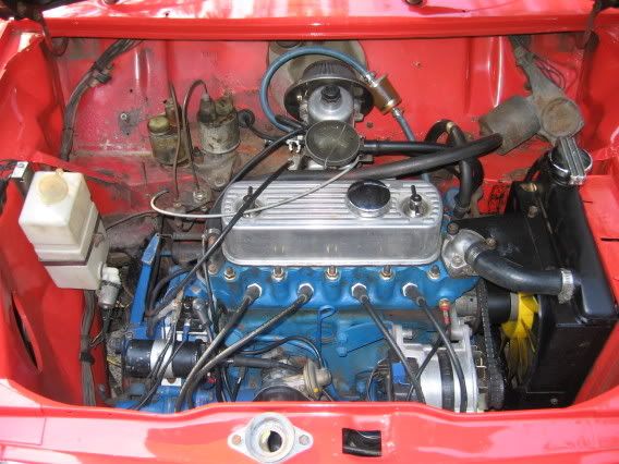

alot of the minis over here run a PCV valve, which was was a factory item on a few models. Its the circle part in front of the carb and the seals in it can be easly replaced so there are no leaks. its basically a one way valve which keeps the engine in a vacumn , thus stopping oil leaks blowby and pressure in the engine.
i will be using this exact setup on my turbo motor but connected to the clutch breather instead. these can be bought new out hear and replacment seals are really cheap if bought second hand.
