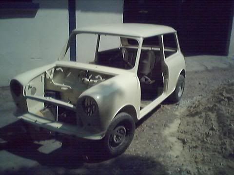

it's an innocenti cooper 1974 shell,
I've changed complete front end,a panels, floor panels, .
just finished the paint.
The genuine colour is innocenti bianco avorio ,it was a little clear so I prefered vw colour which is slightly (1tone or 2) more ivoire...
I'll post picture along the work is progressing

it's coming......

Looks a little naked!
But a good start we hope?
fab
1497 Posts
Member #: 100
Parisien Turbo Expert
Paris\' suburb
naked! but a lot less than she did, imagine it with no front end, no floor ,no bottom seals, it was very very light :).
me too I hope the job will not take month......

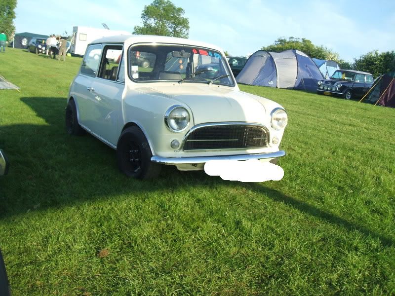

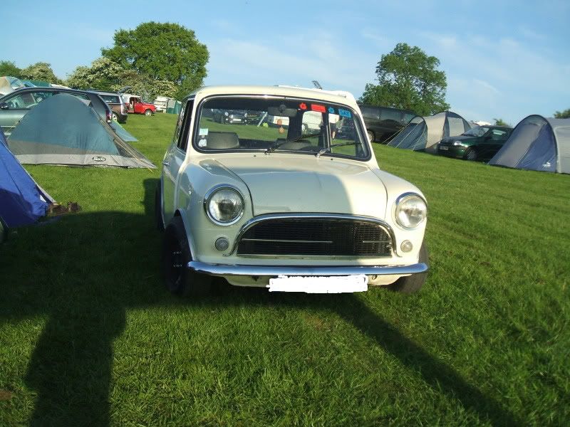

update *happy*
pics from silverstone meeting:
at the show:
Edited by fab on 8th Jun, 2009.
Christ that looks lovely!!!!!!
Very different to the earlier picture too
I like that
t@z
2054 Posts
Member #: 452
Chester, UK
oh my thats very very nice looking.... *happy*
what size wheels are those as i've been pondering 4-5 inch wide wheels with no arches and still dont know lol
actually silly question...its early gonna assume there 5 *smiley*
Edited by t@z on 9th Jun, 2009.
www.twitter.com/lilpinkiy
it looks good in the flesh too, nice to see you and your mini fab,
longy
1547 Posts
Member #: 2727
Bicester
wow love the car, its so clean and tidy
1972 998 TURBO SLEEPER
CR#
140 Posts
Member #: 1367
Cape Town, South Africa

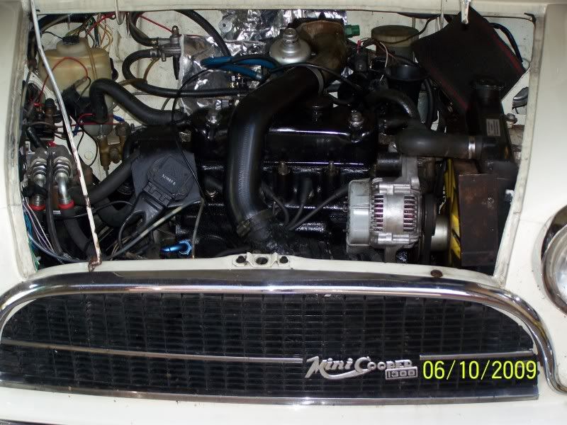

Great car.. excuse if im not up o date with the forum, but what you got under the bonnet??
Very Nice!!
fab
1497 Posts
Member #: 100
Paris\' suburb
Wheels are ruspa , 4.75 inch wide, ten inchers evidently, most important is that they have good inset which help against torque stear.the front tyres, dunlops d93 are lightly wider than the yoks and so increase the eye effect on the wheels.

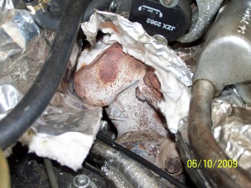

under the bonnet there's a mg mety n/a engine with turbo pistons (20831, lightly worked mpi head,
an all new 1275gt gearbox, with 3.1 diff
the clutch is the weak point , with a verto 2.25mm cover ( turbo one), and a 190 mm clutch plate ,valeo high friction lining, it does slip a bit when high boost is set, but does prevent gearbox blow,and this does work since one year now.
turbo is an home selected/made one fromm kkk turbine and compressor (78/79%) efficiency in my plage of presure/flow, this give compr out temp between 40 and 80°), this blowing thru an s3 intercooler.
don't know power, but it does take the money to a Z3 2.8, and a cooby thru the three first gears..

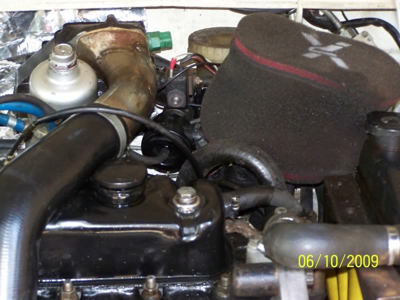

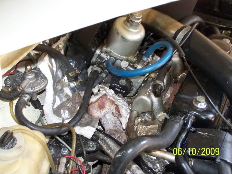

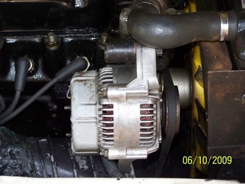

a little bit more:
custom plenum inlet,boost solenoid, dumpvalve,inlet air temp sensor:

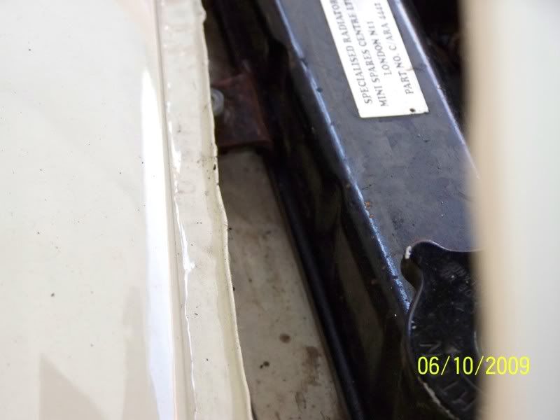

rad holder:

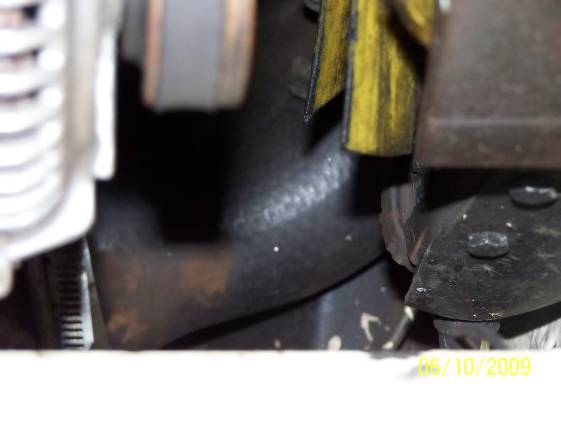

to let the tubing going under:
turbocharger
alternator

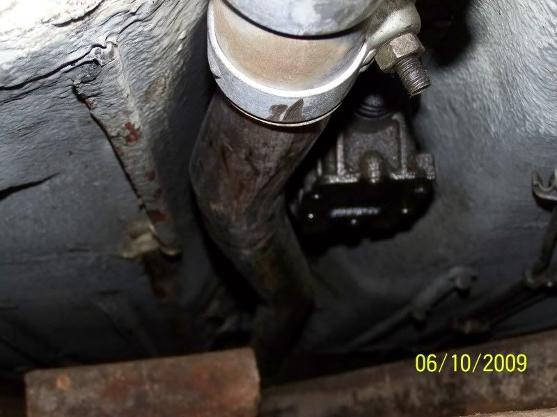

exhaust
