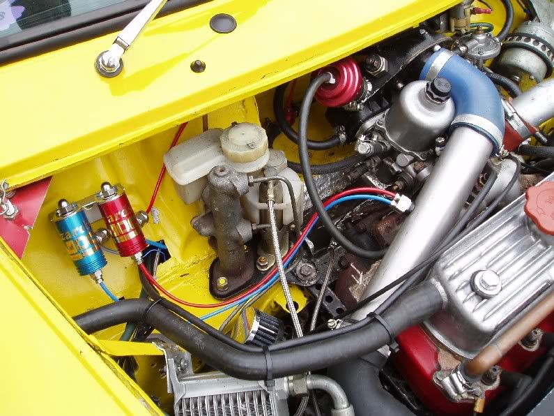

this was the reccomded set up by The Wizards of Nos.
The fuel and N20 into the same injecter, the N20 firing behind the fuel to blast/attonize it.
Works well although i have hardly used it.
JF.
The dual-injector setup doesn't suit the A-series... In some applications (like webers) it's the easiest option - but it ISN'T the best...
The only way is as per the picture that JF has just thrown up. Nice and simple, and no charge-stealling issues (well, no more than with a carb anyway)!
Put simply, if you do it with a nozzle in each tract, then the inside cylinders take 540-crank-degrees worth of nitrous/fuel, wheras the outer cylinders take 180-crank-degrees worth... Makes for a slightly un-balanced mixture.... *wink*
