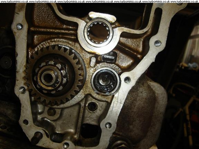

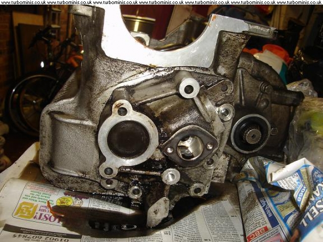

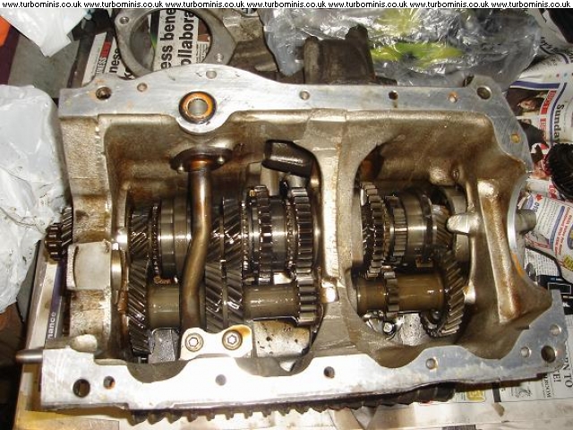

Hi, Im new to the site and dont actually have a turbo mini. Im driving a mpi cooper s with a 5 speed helical box. My layshaft has sheared. I have the new lay shaft, but dont know how to get the old one out...
It runs from one end of the box to the other and is splined.
If anyone could help me out...

Martin, upload some pictures of the box to show us what you mean mate.
jev1987
11 Posts
Member #: 1237
Three photos of the box here, the second photo shows the bearing underneath the idler gear where the layshaft runs, there should be a running surface in there but thats the bit that sheared off the shaft.

Awesome, Not too hard a job to change the layshaft after all...lol... Thanks a lot for all of your help guys.

The main shaft is completely stuffed too, the case hardening has worn away...
might go four speed for a bit...
