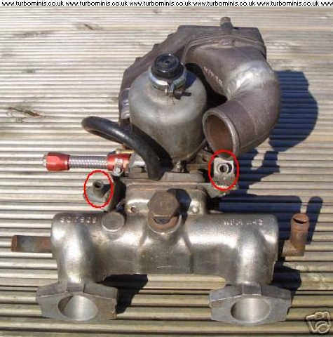

got the plate, but need the actual union things that the cable sits in....like these:
has anyone got some? or can anyone point me in the right direction?

Small piece of tube and a dab with the MIG?

yeah or:
use a mutro outer cable that has the plastic bit to slide in
and the choke uses one of those annoying clips that always drops down the back of the subframe
yeah cheers guys
ill fabricate something if need be, but would just rather the pukker parts if poss
As Nic says, the bracket if it is off a metro will have a slot for the throttle cable plastic thingy to slide into, and will have the fixing slot for the magical diasppearing clip on the other side.
Other option is to get hold of a carb cable plate off a mini which should look like the one in your pic above.
I personally run a metro throttle cable, it is just as easy.
cool, cheers tom, just ordered one for 2.99 off fleabay
