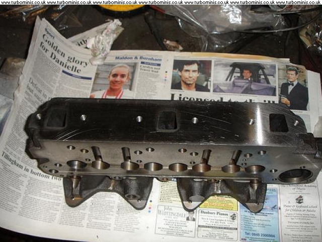

Stuart Gurr worked on my minisport one, he said the were diferences to an AKM one he have previously worked on.
he didn't go into details, but mentioned being thinner around the exhaust seats, and generally a rougher casting.
everything i have heard about the AKM points to them having 45mm intakes (to suit a 45 dcoe) mine is a shade over 39mm at the carb face.

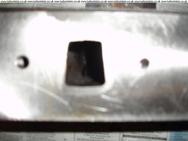

Also minisport have cast their tapezoidal exhaust ports into the head, Stuart ripped these out to a decent size...
here is what they were like as cast.

Fantastic, thanks for the pics. As you say those exhaust ports look pretty small, time to give Stuart a ring for a chat I think and add a 7 port onto my christmas shopping list!
another thing worth noting is Stuart was wary of going past 24cc chambers, so you'll need deep pistions to get the cr down.
