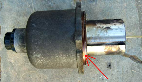

also is this groove what you meen I need for the dashpot seal?
no. It is a groove in the main body of the carb.

I thought i could just mount the dashpot assy. in a lathe and cut a groove, mounting the carb body may cause headache.
