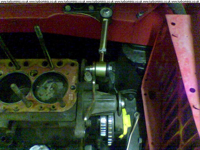

Avonbars ultimate engine steady looks to be a good bit of kit, althogh i havent driven a car fited with one yet.
its diferent to the usuall one's in that it fixes to the waterpump so you don't have to remove it when you take the head off, also its adjustable and takes std type/poly bushes so could be changed for a rose jointed dog bone.

here the one on my project car

Funny. I've just been looking at your photo album as well. And you do have one.
Does it clear the belt drive for the water pump.
Looks close from the pics.?
it does look close in one of the pics but it's just the angle its taken at, theres a good 10mm (prob closer to 13mm) clearance, and thats the large beltdrive pulley.
i think the plate on the water pump on these could do with a slight bend to put less stress on the rubber.

Looks like a sensible idea, a rose jointed tie bar would do that quite nicely.
Think I’m going to you this as inspiration in making one. I've already had to modify my pump to take an input from an electric pump.

thinking about it I'm not sure how well that avonbar steady will hold up as the bolts are only in single sheer, It sould be ok in my car as I have a remote box anyway, just about the best steady ther is!! but with a rod change box i'd be keeping a close eye on the std dogbone bushes so the avonbar one only ever acted as extra support.
If i get bored may mod the avonbar one though, althou it could be a it tricky geting the bolts into double shear...

I agree, the Avonbar one picture above is great!
