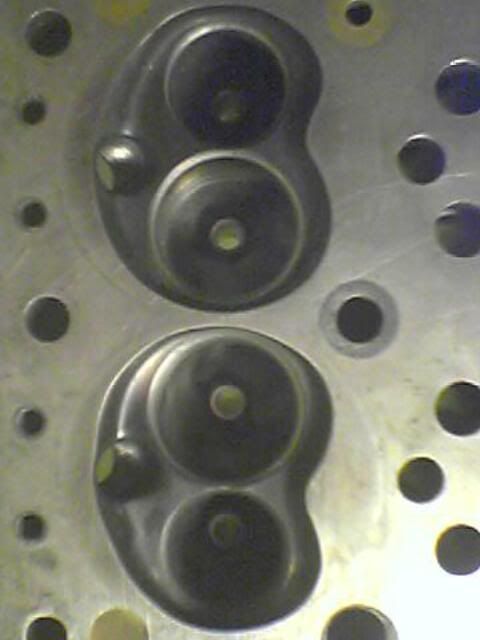

![]() 1497 Posts Member #: 100 Parisien Turbo Expert Paris\' suburb |
13th Nov, 2006 at 05:16:03pm
Hi jukka!
| Home > Technical Chat > 7 mm exhaust valves stems? | |||||||
| Page: |
but I have to find a set of 37.7 inlets (my head already have this size, the valves stem are well worn and I can't downsize) .I'll enquire from them if they can source them...
