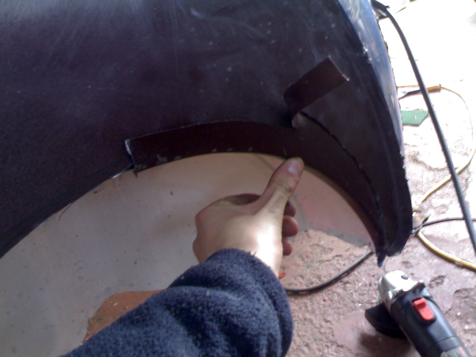

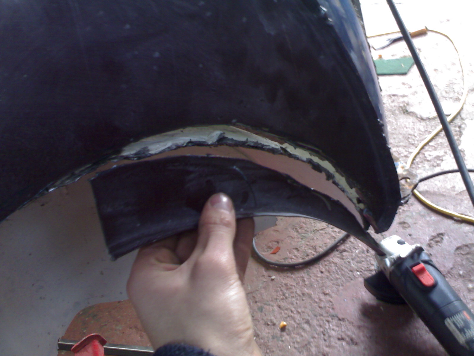

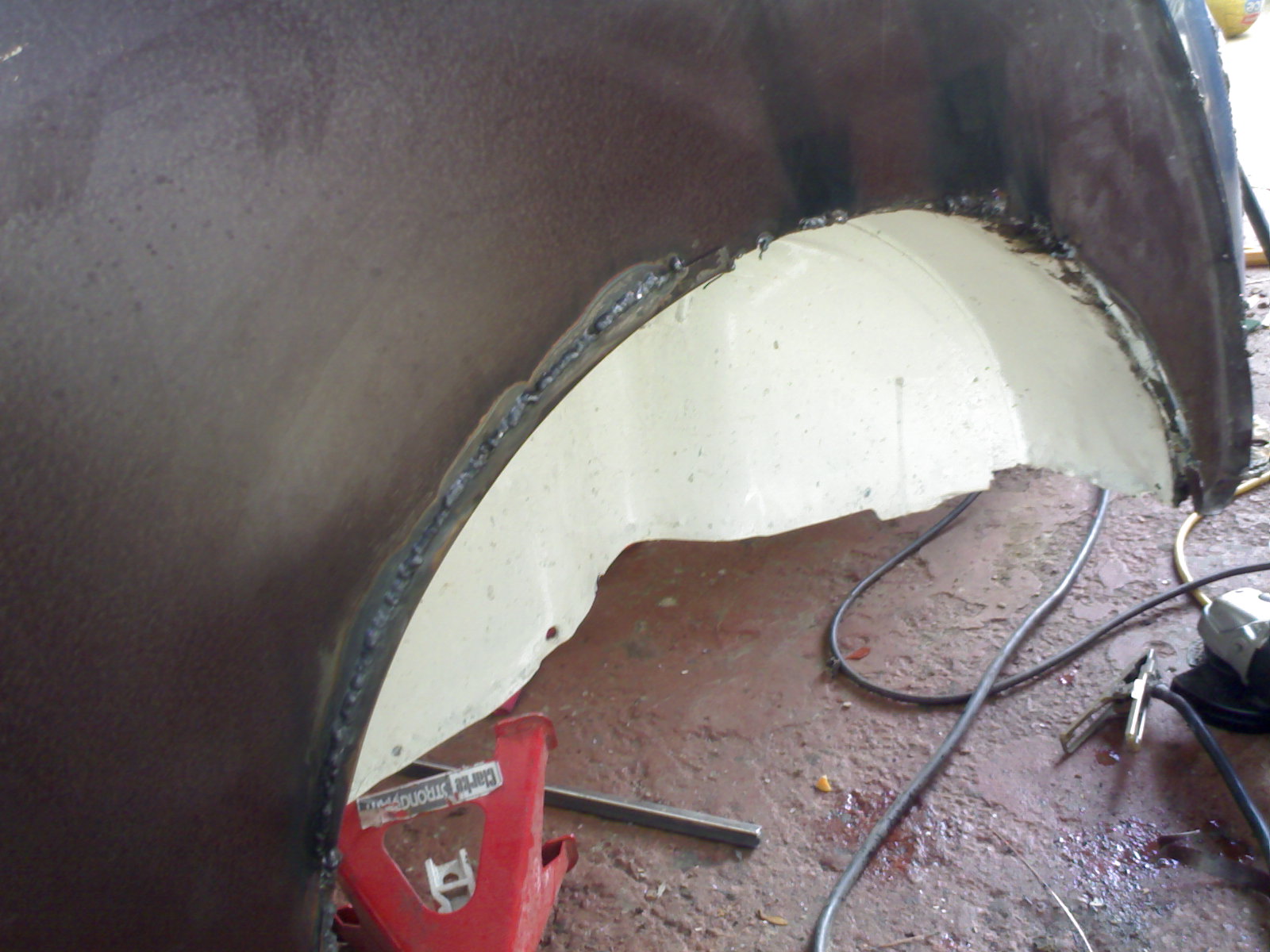

I have posted up some more pics of the work in progress on my Miglia Lookalike. I have also included some pics on the tubbing of the arches as i think someone was asking about this a while ago.
What i have done is spun the off cut around of the wing and welded it back on to give a nice soft edge incase the tyre does hit the wing!
