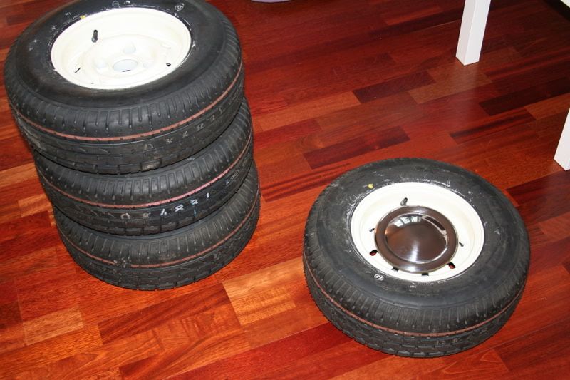

vegar
520 Posts
Member #: 189
Got the new wheels :)
http://i5.photobucket.com/albums/y171/vegarj/IMG_7713.jpg
had to test them:
http://i5.photobucket.com/albums/y171/vegarj/IMG_7732.jpg
http://i5.photobucket.com/albums/y171/vegarj/IMG_7738.jpg
And the best part, no torquesteer :) I only tested the for 30 min, and they got brand new a008, but on my little testrun it was no torquesteer :)
