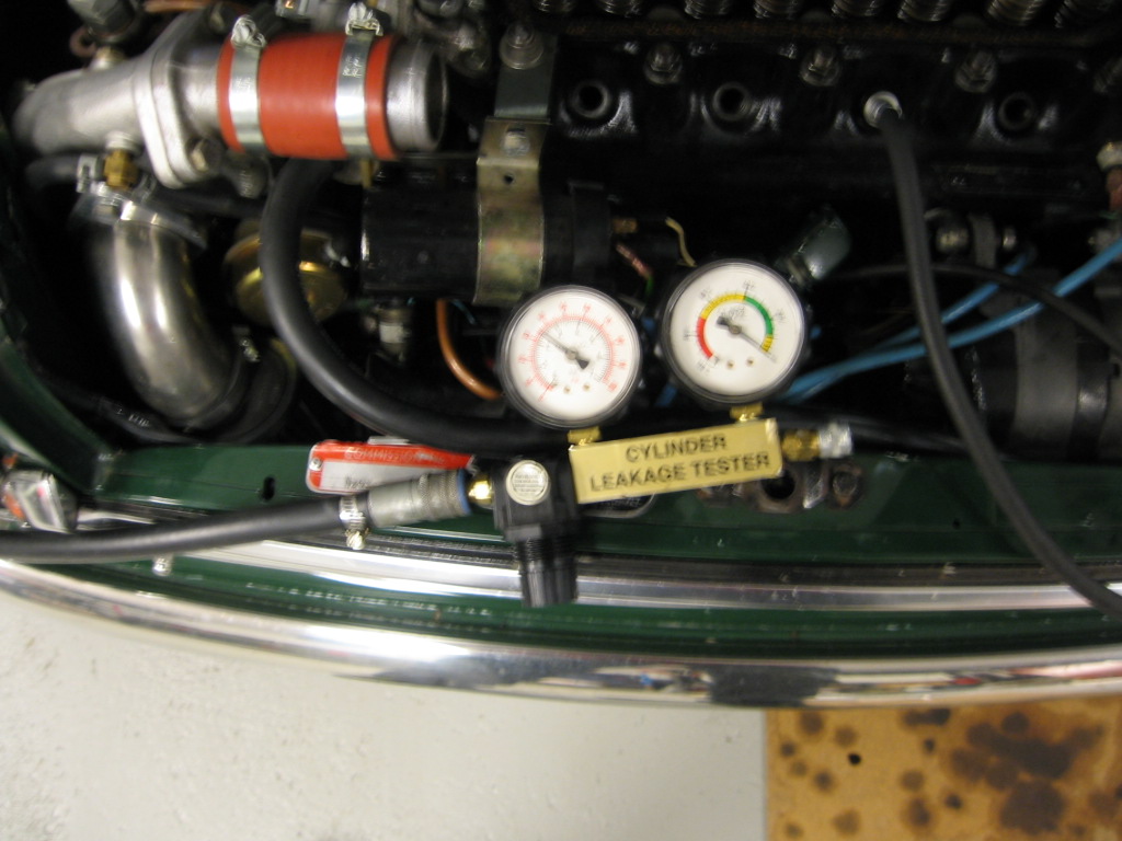

Hi!
I havent been on this forum for a long time, but now I need your help!
My engine is smoking a bit to much. It has goten worse by time so I need to do something about it.
In my search for whats wrong I have rebuilt the head with new valves and guides. I have change the turbo to a new one (although it had been on the shelf for a couple of years).
I dont think its the turbo because it smokes even if I disconnect the pipe between the turbo and carb (and there is no oil inside the pipe). If its the turbo its got to be leaking oil on the exhaust side but I dont think this is the case!?
So, the next thing I thought about are the cylinders and pistons. I bought a leakdown tester to find out if the bores are worn.
Does anybody have any experience with leakdown tests!?
The leakdown tester measures leakage at a give pressure, this is the result I got:
Cyl1 1bar:64% 1,5bar:47% 2,5bar:10% 0%leakage@2,75bar
Cyl2 1bar:64% 1,5bar:47% 2,5bar:10% 0%leakage@2,8bar
Cyl3 1bar:64% 1,5bar:46% 2,5bar:7% 0%leakage@2,7bar
Cyl4 1bar:67% 1,5bar:49% 2,5bar:15% 0%leakage@2,9bar
From this I can see that Cyl 4 has a bit more leak than the others, but is this difference enough to say the no 4 cyl is worn?
How do I know if all cylinders are worn!?
If somebody has experience with leakdown tests or know of another way to tell if the cylinders are worn, all help is appreciated!!
Have a nice day!
/Jonas

This is the one I have, but I gues it works the same way as yours:

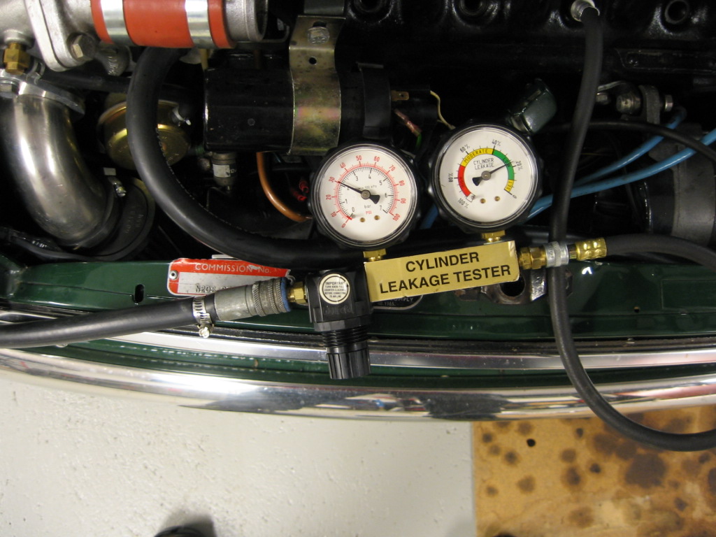

I have done a new test, the right way this time *smiley*
I set the gauge to zero and then connected the airline from the cylinder.
I did the tests a coulpe of times and got some different results but the overall leakage is as I understand it to much (even if the gauge says "Low leakage" between 10-40%).
Could this be the cause for the smoke!?
Does these numbers tell me its time for a rebore?
Cyl: Test1 Test2 Test3 Test4 Test5 Test6
1 10% 8% 9% 23% 24% 24%
2 15% 23% 23% 23% 24% 24%
3 21% 23% 22% 24% 21% 34%
4 27% 15% 15% 29% 30% 30%

if thats liek the leack down tester i have you need to ajus the regulator to get the left gauge to show 100psi, then note the reading on the right gauge.
do this with the cylidner at TDC on teh compression/firing stroke, with the car in gear and the hand brake firmly on.
Denis O'Brien.
Jonas
76 Posts
Member #: 61
If I adjust the left gauge to read 100PSI, the right gauge will go past 0%(-xx%)!
