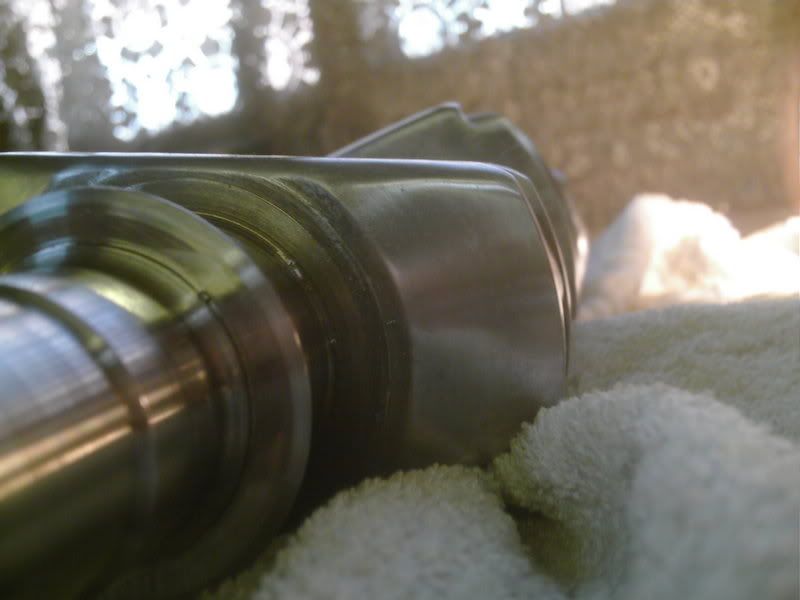

http://i24.photobucket.com/albums/c2/carl1964/DSCI0033.jpg
when trying to be a real clever sod boring a hole through the crank tail all the way to the web,
is firstly not to get the drill bit stuck 3/4 of the way down,
and to stop short of the main journal so as you don't bore through the oil passage to the big end, doh, an alloy plug walloped down the bottom of the hole should cure it ,lol.

plenty of lube carl and take your time on the next one
the back footers i have done over the years ........ Oh!! s**it!

http://i24.photobucket.com/albums/c2/carl1964/DSCI0035-1.jpg
and finally it went back in tha lath and machined about its periphery.
you'll notice it along the b/ends if you look closely.
