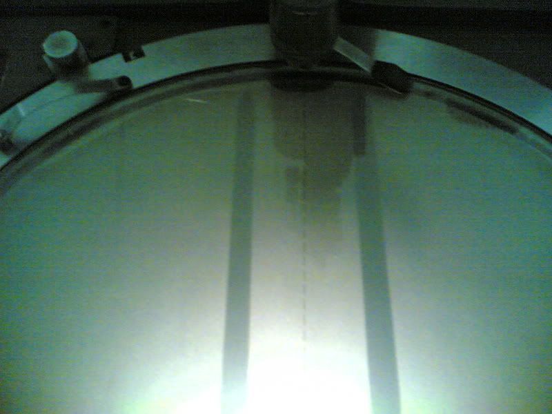

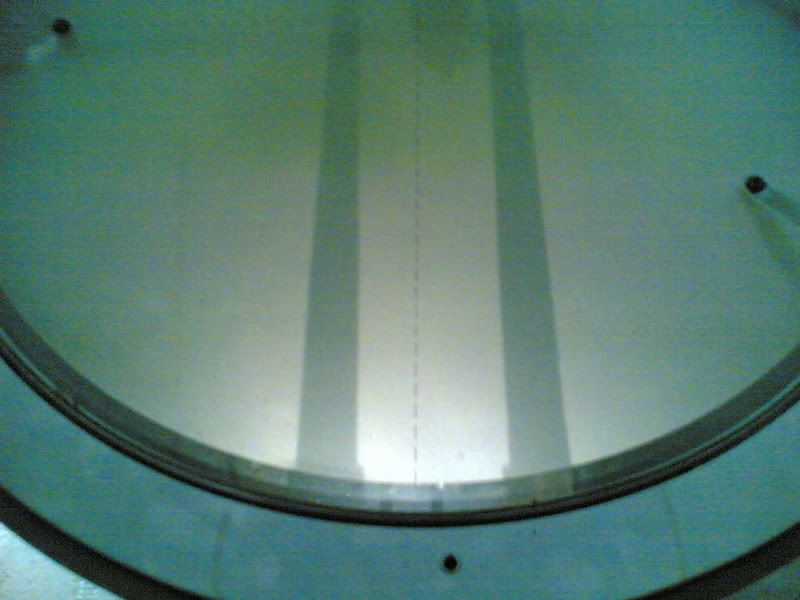

So the standard 10psi avonbar needle is approx .004" thinner in the middle and .006" at the pointy end
Dangerous
2521 Posts
Member #: 417
Heres the pics at 50X on the shadowgraph
