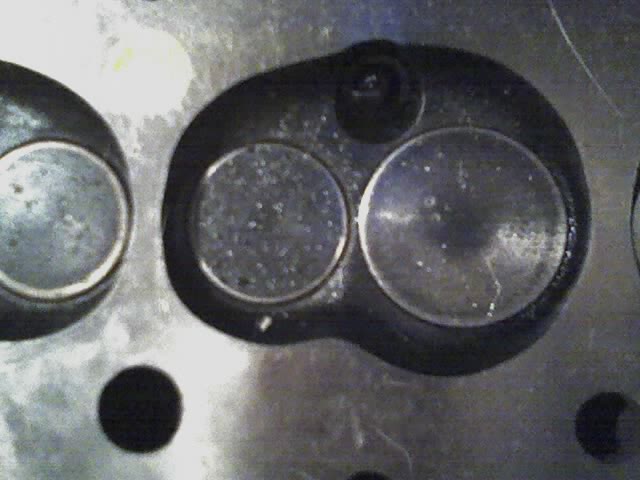

hi, i dont want to run sky hight boost, but is it worth removing the 'beaks' from the chambers on my head?
Turbo Shed
1303 Posts
Member #: 30
Epsom, Surrey
why would you remove the beaks? the beaks are good
welshdan
2096 Posts
Member #: 1111
s wales
i read that avonbar remove them,,,,, stop hotspots? wouldnt it lower cr as well?

It'll work shite with a 286, as it has FAR too much overlap for use with a turbo.
The little beak you've got on your head there is not worth 0,5cc. Keep it, get the proper pistons.
How big are the chambers at the moment?

I agree with Tom, bin the 286, it'll be awful to drive. MG metro of Avonbar PH2 is what you want.

regarding the pic of mt head chamber, my dad has access to the machining facilites via work and mates, was wondering if you keep the beak, where do you take metal from? is it both the beak side, leaving the general shape of the beak, the side where the sparkplug comes through or both? also, isnt it a good idea to remove the beak? wouldnt this give hotspots, leading to holes melting in the pistons on a turbocharged engine? any info apreciated, thanks

Keep the beak ...... Won't give hot spots, will improve combustion dynamics and if your going to reduce it do it evenly so that the remaining beak is similar in form to the original, just smaller.
Plenty of metal to remove to lower CR before the beak pops up the list.

IMO remove the beak
Alot of peeps will disagree!
It's a bit dirty but hopefully this should show where you can remove metal from with out removing the beak:

what sort of cc is that head rob?
Rob pm sent
Simply machine the standard Turbo pistons, you can achieve 8.5:1 CR with a standard 21.4cc chamber head *wink* the standard pistons are tough old boots even when machined 'correctly'
Keep the beak.

Haven´t changed my mind, keep the beak. Cut it back if you wish but don´t remove it completely. I´ll take a photo of my cuurent head and upload it later this week.

Am i right in thinking the beak is there to produce swirl and get a more efficient burn? If this is the case, surely it's not so much of an issue on a turbo engine as you (should) have at least 7psi of boost to force it through with. Although in saying that, you can run 7psi on 9.4 CR pretty confortably if it's set up right.
Save your money, ditch the cam and stick an mg one in. Spend the money on an intercooler setup instead.

The beak gives you alot of squish area, pushing mixture towards the plug for a faster burn yes?
I kept it, its there fore a reason and so long as you dont leave a sharp edge on it then i cant see it would get much hotter than the rest of the head (exhaust valve must get hotter!)
(Thats for 8.5:1 with stock turbo piston's)
Edited by slater on 12th Dec, 2006.
26cc

the beak doesn't only push the mixture toward the plug it mainly create a swirl that force the burned gas to go away and not stay in the comb chamber, then a faster and more efficient burn is made, burned gas making a wall to flame front, then your unburnt gases need more time to "see" the flame then the combustion is longer and you have passed the peak crank angle efficiency, so you have less cr but more knock index ,less power and need more ign advance :/
