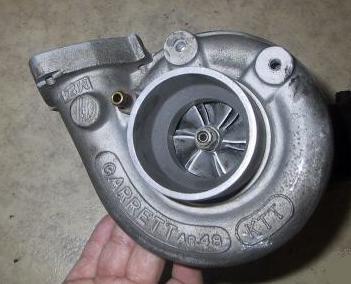

Can a Nissan T25 turbo from a 200SX S13 be used with the mirage manifold?

it will fit but may not be suited to a 1275 if it as the 0.64 exhaust turbine.
you will need to grind the back of the block and possibly the turbo housings to get it to fit but this is no problem.
i've done the same myself on a large T2 compared to the R5 one.
It should be the same T2 flange bolt pattern so fine from that side of things.

Dam it. I just wanted a bolt on and go job :( Which T2 and T25 turbos can be used? From which cars?

Its not far off.
Only a T2 from a R5 i'd say is a direct fit.
Anything much bigger and you need to fettle castings. Well you do on mine.
Its dead easy and not exactly precision.

that's really a big turbo for an a seri!
what's your boost/power?
Even the R5GT needs a little work as it needs studs removing and turning into clearance holes...

Ahh yeah forgot about the turbine housing ones.
But its all stuff an angle grinder and drill can soon fix *smiley*
And to be honest if you cant do those bits i wouldnt go with the mirage manifolds are there are numerous little bits to make up for them.
Nothing too hard but needs a bit of time and effort!
