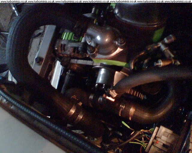

Anyway, this is how far ive got, undecided on where the expansion tank should be placed, you can kind of make it out in the drivers side wing but i thinks its a bit too low?
looking good
ive put the wiper motor inside the cabin and gonna place the header tank there, might not be the best idea on a road car though, from a noise point of view...

I like the front mounted rad, is that a hard conversion? What sort of rad hoses did you use? Mine is a clone of yours, I am using the same IC but was going to turn the end of it 90 degrees up to clear the side rad. Maybe might go front rad instead.

The conversion isn't that hard you just need to make a crossmember to support everything really, mines just bolted through the inner wings.
The hardset part was finding hoses to fit!

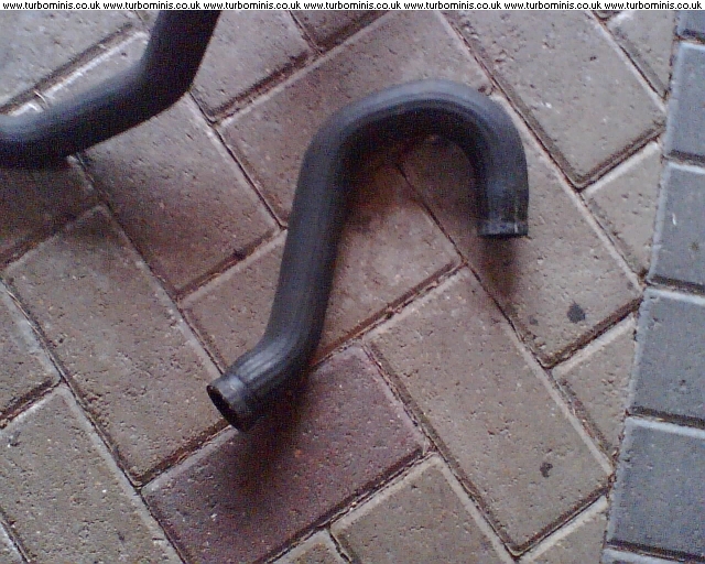

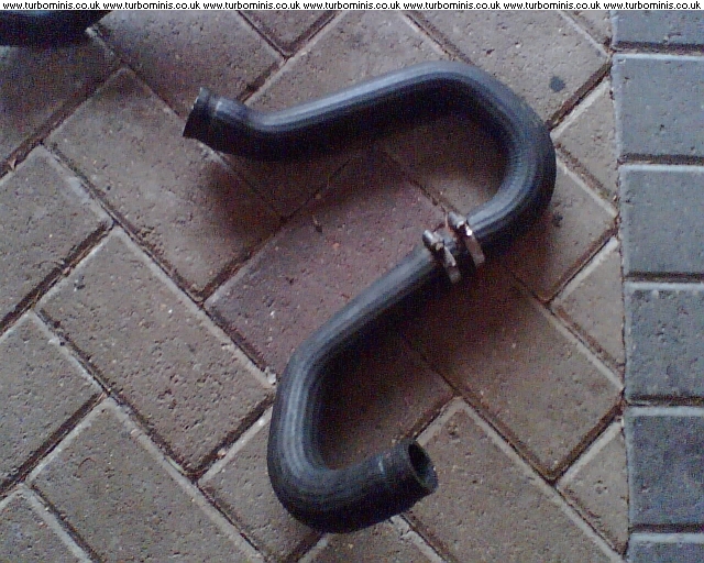

You need three of these from a rover 100 's (petrol as deisel are different). And one other hose also from a rover 100 (petrol)all got 32mm ID.
This is the hose that fits between the water pump and bottom rad. Its also got the heater matrix take-off.
This one fits between the thermostat outlet to the top rad.
It should work for most front mount rad with similar positioned outlets, 32mm seem to be a fairly common size aswell.

The hose that you show above from the water pump to radiator with the take off; you shouldn't use this for the heater as it will pass hot water into the cold side of the system. Better off to use the metro style sandwich thermostat housings, with the lower part that has the heater take off below the thermostat.
