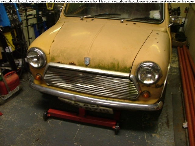

How she looks after over 4 years in a garden

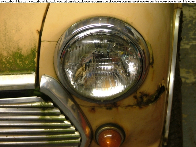

The worst rust I've found (although there are some bodges to fix)

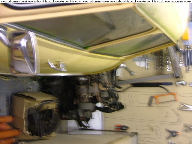

Lurking at the back is the heart transplant ... what a £50 Turbo motor looks like and that saw is proof that Candice srinks things when she washes them .... thus proving I'm not as fat as my clothes make me look (yeah right!)

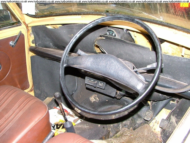

Classy interior from 1 lady owner

The interior is the place most work has to happen ..... there has been talk of full leather retrim and even a question about air con!!!

I like the tool board but weres the tools got like the hack saw
1293 Turbo mini

Your right though I have to do good tidy up before getting started properly but for now I have been concentrating on getting her stripped enough to look at the major panels as I want to make sure Ihave everythign for Xmas week.
So far the only rust to deal with is in places where it has had the back street garage bodges for MOTs.
The heal board could be repaired but false economy so will be replaced.
One sill is not brilliant but I will do both so I can see inside the box sections.
There is a small hole at the bottom of the passengers side front bulkhead / fitch but I can let metal in there.
Going to do both wings as they aren't great and even though the A panels look ok they are being done too as it in't sensible not to at this stage.
There are a couple of little bits here and there but all in all I hope to have the shell ready for paint early Feb. Now that's cursed it hey.
Intention is to mock it up in Feb, then strip, paint and rebuild. Candice's birthday is late March so I hope to have it ready with a big bow around it for then!!!!
