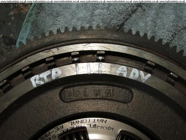

Here are a few pics of how to adjust the ignition advance on Spi and MPi flywheels. Obviously the amount adjusted is right across the ignition map. This is how the expensive Superchips icon works, but electronicaly, well at least on the older ones it does.
My aim was to retard the ignition 5 degrees because i had increased the compression ratio and under load the engine was pinking badly.
After fitting the other head which again pushed the compretion ratio up, i decided it was time to do this rather than relying on the fuel octane.
Its simply a matter of marking the reluctor ring on two teeth, bend the innermost teeth into the center with a small screwdriver, pull it out , bend the teeth back again with a big screwdriver with a twisting action (any other method seemed to bend the whole thing all over the place), place it in the groove with as close the amount of advance or retard you want and then hammer it home.
Job done
Hope this may be of use to some one*tongue*

The SPi uses 5 degrees advance on turn over to start. Knocking the advance back 5 degrees, 11.2:1 compression ratio, 99 octane fuel and cold weather = difficult to start*angry*
Going to advance it by say two or three degrees again.
Other than that, it runs great, no pinking what so ever.
