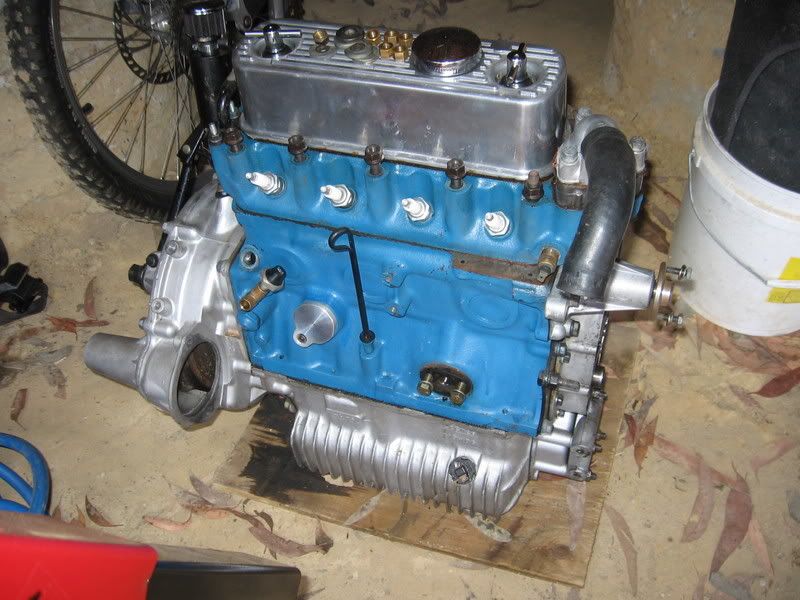

iv had my engine running for a while now but the dissy curve was never right , i had a nissan pulsar dissy recurved for it which went pretty good. One week later on the way to work there was an odd knock and on the way home the the pulsar distributor locked itself (bushing ran dry). SO instead of getting another one and recurving it i looked out for a mety turbo dissy but they are quite difficult to find out here so i took all of you guys opinions and i did it
MEgajolt:)
thanks nic for convincing me i dont think ill look back
still a bit of work to do setting it up, but shouldnt be too hard i made the nice distributor plug at tafe too
should make the front of the engine much neater too

hey grant ,
i ordered the coil , sensor , wiring ,edis4 and 5.125'' trigger wheel from (pick and payless blacktown wanted $150au just for the coil)
http://Trigger-wheels.com/ (very easy to deal with and a great help)
megajolt lite jr computer with map sensor
http://picasso.org/mjlj/?q=node/11

Hey Ben,
yeah i have spoken with them both, I was actually going to go to P&P this weekend for a look but if they are that dear i wont bother.
you can get the kit off ebay for 35 pound plus postage.
