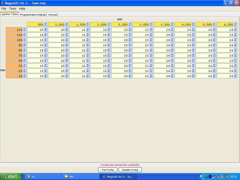

Finally got back to uni where i have a good computer, here is the base map Alex gave me that a few people were after, if its in the wrong section or there are any errors please feel free to move/modify it, maybe it could be a used as a map to start on for the new mj map section *wink*
