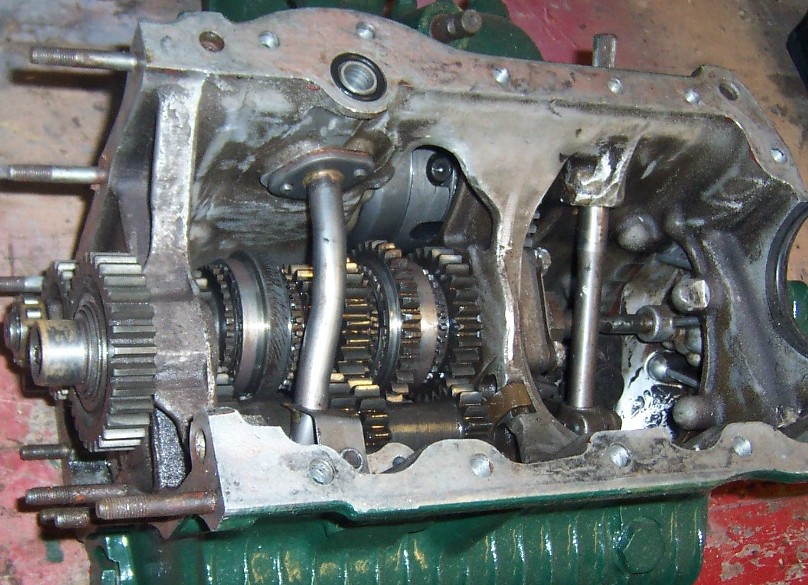

Vegard, Perfect use of Anglo Saxon by a Viking, love it. I will be using a mapped ignition so the distributor is not an issue.
Will, I hope this should help with the potential drop gear problems.
(see picture).
I have just spotted in the Haynes Metro manual that the differences were :- hardened crank and hardened valve seats but no mention of the block.
As you have probably figured, I already have an A block and being a tight yorkshireman I want to use it but I am prepared to be talked out of it if someone can give me a reason.

On 5th of Jan, 2007 at 02:08pm wil_h said:
I'd use the A+ purely because the drop gears bearings are better/stronger.
But, that has got fuck all to do with the choice of block *wink*
Quite right, I was being a twat. Sorry. My tiny brain was getting confused. Use a later box duurrrr.
Can't see a problem with the A block then.

6965 Posts
On 5th of Jan, 2007 at 03:00pm danboy said:
Thanks for the quick concise replies.
(see picture).
Regards
Dave
AH!! green paint ,a good choice and always contrubutes to gearbox integrity, and if combuned with a green engine should see you have years of trouble free racing,
danboy
715 Posts
Member #: 1381
Spot on Carl, It's British Racing green So it should last even longer
Yes?
Dave
