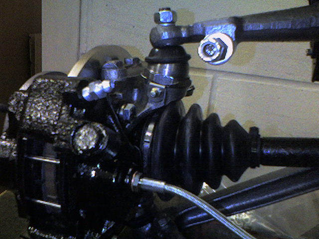

After purcasing a pair of outer cv boots earlier in the week, and finding them a lousy fit, I spent a few hours yesterday morning trying to tell the monkey behind the counter in my local parts factor that the ones I wanted was for the cooper s asy, after much deliberation and head scratching he gave me a set which I though looked very similar to the '84 on disc asy (but he assured me they was what I wanted).
I ceanly made my way to work (where Im building the subby up) and fitted the boots and reassembled the drive shafts (cv boots fitted nicely!!). I then fitted the shafts into the hubs to find THE BOOTS FOUL THE HUBS!!! WHAT A DI** HEAD, a whole morning wasted!!!!

Not sure if they are?? checked them against the ones I used on my other mini, and they are the same (runs 8.4" not 7.5" so not an issue.
I might gain a little clearence when the engine is on it and in the shell, Im not going to adress it untill I know its going to a prob fop sure.

But the only difference between 7.5 and 8.4 hubs is in the nose that the disc fits over, the CV side is the same.
Those in the picture certainly look like the wrong ones but with the suspension on full droop it will be compounding the problem - have you fitted the rebound buffers? If not try that and then see if there is any touching.

I thought the "S" ones had an inch long shouler at the cv end of the gaitor to move the consentina shape away from the hub to clear (correct me if im wrong).
Yes all the rubbers are in place, agree that with the sus just hanging may be compounding the problem, I may find when the subby has weight on it, and the sus settled that its not an issue.
