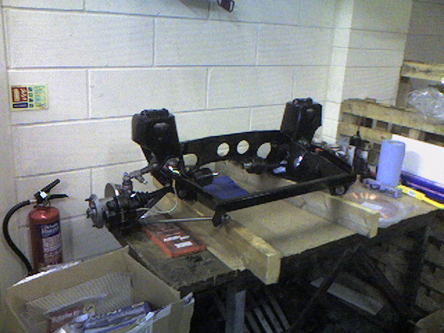

The missus has been at work all weekend so has left me with the whole weekend free, so I've locked myself in the workshop and been beavering away all weekend!!
I now have finished building my front subby (less brake line, and possible CV gaitor swap). I have also stripped all the rear suspension down inpected, cleaned, and given 2 coats of paint. When dry all should be ready to assemble, just need to get my beam axle on order in the mornin. After this, its on with the engine!!!

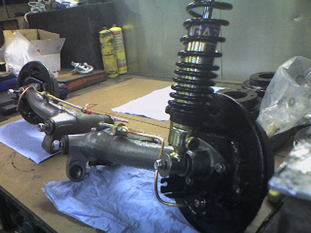

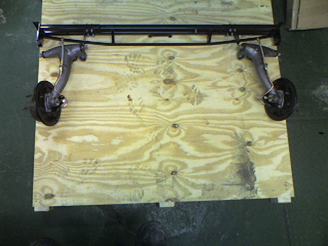

Been back at again tonight, beam axle arrived today (damaged, but thats another storie, bloody hudersfileld...) managed to get radius arms back together, with brakes, just need to fit the split pins for the bearings and slip the drums on, PROGRESS AT LAST!!

You need to make some brackets to support the other end of the stub axle. Std diameter pins will not last long with coil overs - I speak from experience when I had a pin let go (shear) on the M25 a number of years ago and had to get recovered. KAD arms use a thicker diameter to compensate when you use coil overs.

Looks good and so does that work shop.

Turbo shed, its my works workshop, we've got loads of space, heating and tea making facilites (and no nagging missus!!), what more could you want, its the tits!!!
Scruffy, can the pins be replaced, do you have any pics of your supports? (if you dont mind shareing?)
thanks
Shane.
