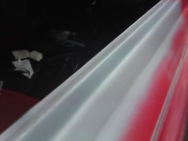

started on the rust at xmas, got it out there even though it wasnt too bad as am aiming to respray the whole car this summer. was a bit too cold for the paint at the moment, as you can see from the slight hairline reaction. think it was from cold/moisture in the air
