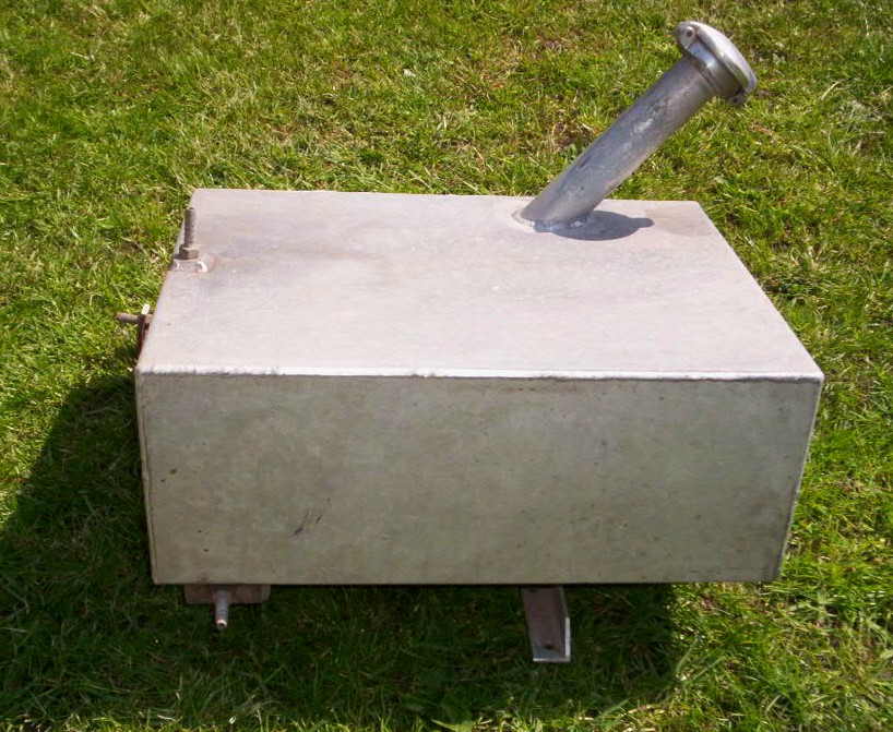

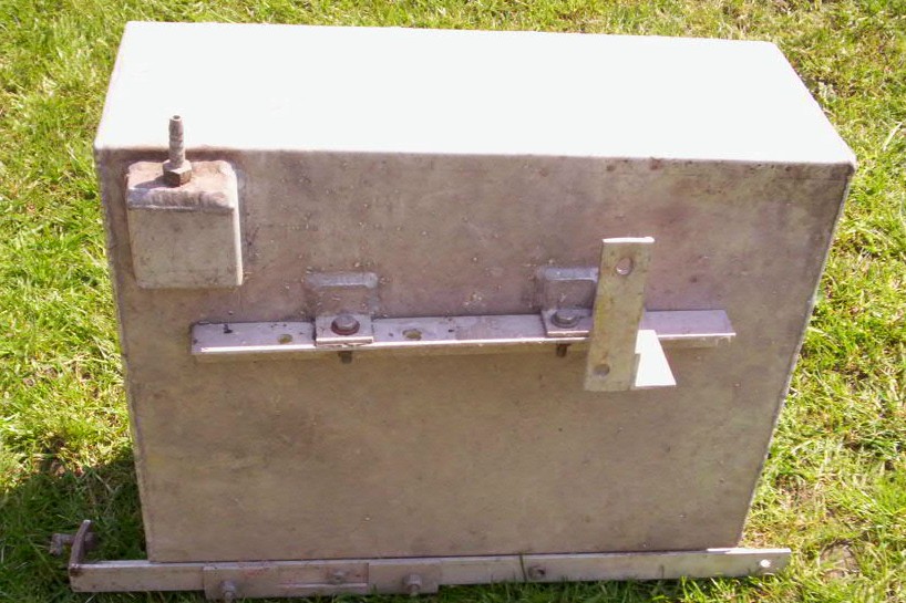

9407 Posts
here is a photo of mine, which is forsale if you want to make me an offer.

9407 Posts
ok clubminiflip was the first to show an interest, followed by gav, and stig.
It's a 5 gallon tank, with vent and return, £80

9407 Posts
yea my connections are push on, he can make anything you likem, put the screw on connections are not cheap. Around £25 each for male and female, so thats £75 added to your tank!

9407 Posts
As I run fuel injection now, I want to make one with a built in swirl pot.
Is anyone stil interested in my tank, or shall I ebay it?
