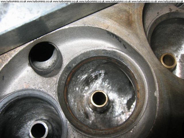

Had new valve seats cut, and when i have started to lap the valves into the head, it appears the inlets seem to have a very thin seat in comparison to the exhaust.
(Click to enlarge)
Should/can I grind the exhaust out a bit more to leave a thinner valve seat? or leave as is?
Should i have thought about this before having the valve seats cut?
Also, its not got u/l inserts, so will a wider valve seat be beneficial wear wise, or make no difference?
I think viz mentioned somewhere that valve seats only needed to be about 60 thou wide...well my exhausts are nearly twice that...
Any advice or pointers would be appreciated.
Joe

Just had a look at this. The guy who has ground your seat is obviously a wanker. Look at where the seat of the valve is. It's on the inner side of the existing seat. So where can you grind?

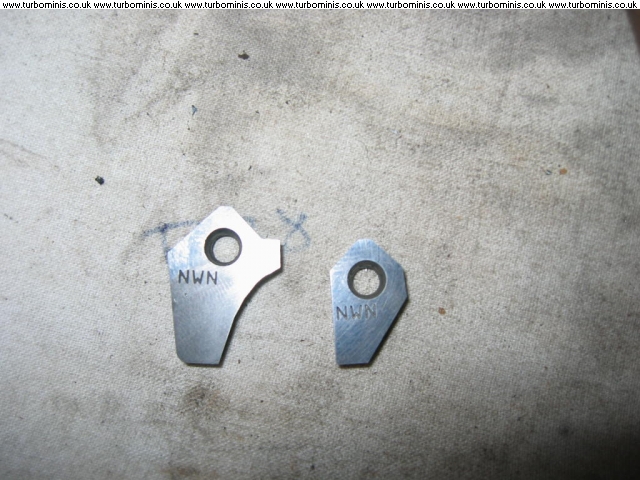

Here is a similar example from Minisport
Horrible 45degree seats cut with something like the thing on the right on this picture:
When grinding new seats on this head with proper equipment, we ended up with something like this:
The inlet valve is the same size, but the valve throat is 2mm bigger. That means that the head is effectively fitted with a 2mm bigger valve alathough the valve size stays the same.
Look at how much meat which is removed
I'd take the head to someone who knows their ass from their elbow.
go up a valve size on the inlets to 35.6mm and de shroude around the combustion chamber so the valve flows well
i dont hold much hope out for reliability with that seat
its too far down
If using a proper cutter, this will sort out the shrouding as well.

no, 30.93mm inlets, its a 295 head, not after mad power and concious of it cracking so sticking with smallish valves.
hmmm, it was doen by a local firm called Motivation, as far as i know theyre the only people on the island that cut seats.

Even so, fit bigger inlet valves. That is no good even if used with a 3 angle cutter. That will just ruin the next up size valve seat.
fishtits, just bought those inlets :(
veg, fitting larger inlet valves and then de shrouding around the valve to bring the flow Potential up
also opening the valve throat to suite the larger valve, these two mods togeather flashing the head will make a stormer of a head
also to flash the head to bring the cc in the CB back tho what is there now , what joey wants

The proper cutter will do this. The one I pictures would make a nice perfect radius there. Look at the pictures of the finished seats I posted. Yummy! Nice venturi effect as well.
yes i agree V if the seat was cut like yours to start with but..... the valve seat has been taken too wide and the valve now sits on the btm of the seat
not good in my book
Exactly, so a bigger valve and a proper cut seat would make that head beatiful. There's sufficient meat there to do it. Buy 32mm inlets from Paul Ivey.
will keep you posted V
had a closer look today and i think you guys are right... :(
