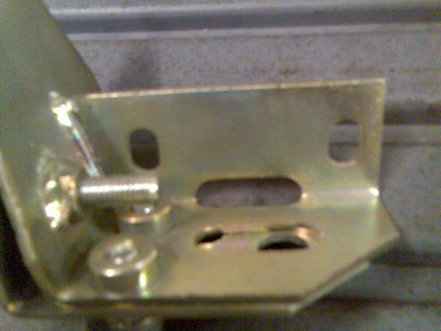

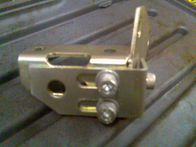

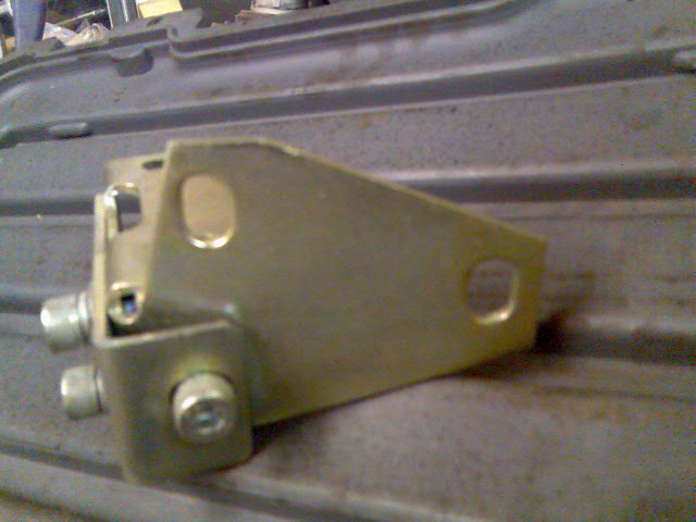

my brackets, are these just for camber or can i adjust the toe in? cheers
Not seen those before. But yes, they appear to be camber only.

i got them from min-its about 5-6 yrs ago, could they be modded so the toe-in/out can be adjusted?

They're the same as mine, toe can be set by using shims as said above. I think KC sells shims for rear camber brackets on his site but they're easily made from sheet or old oil/waxoyl tins!

Camber only, same ones I use and trust (had very bad experiences with toe adjustable ones as I said).
Shims are available, so is shim material to get it spot on. I must admit that I fit the thickest shim, measure and grind to get it exactly right if it's not one of the available thicknesses.
