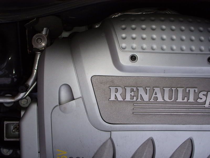

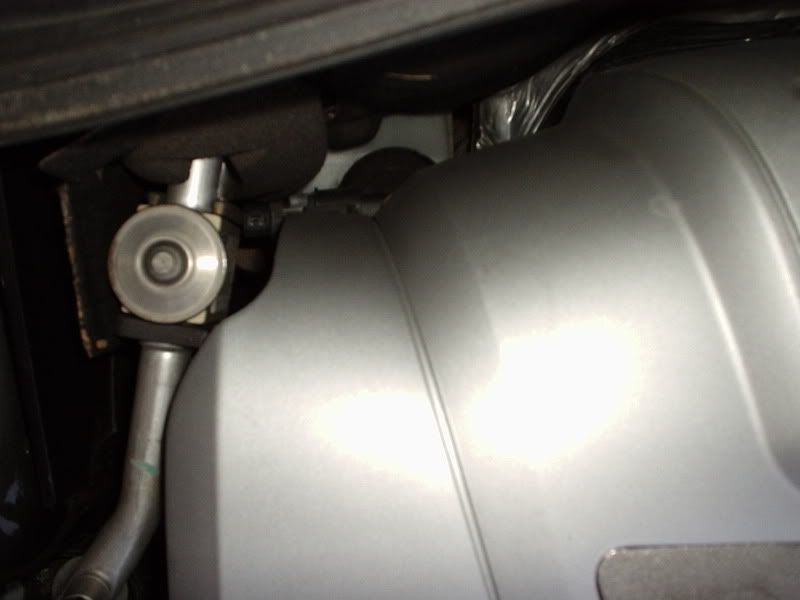

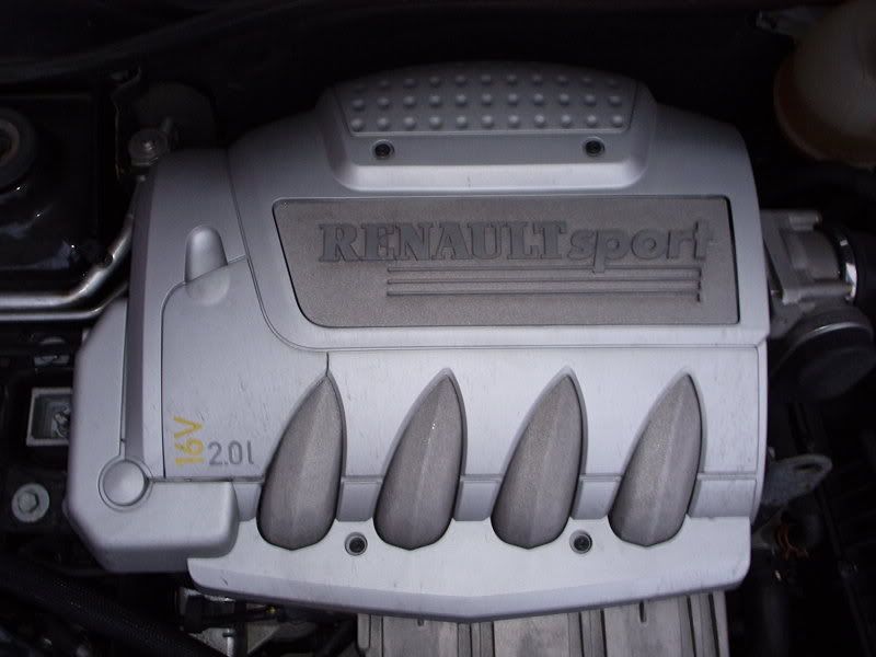

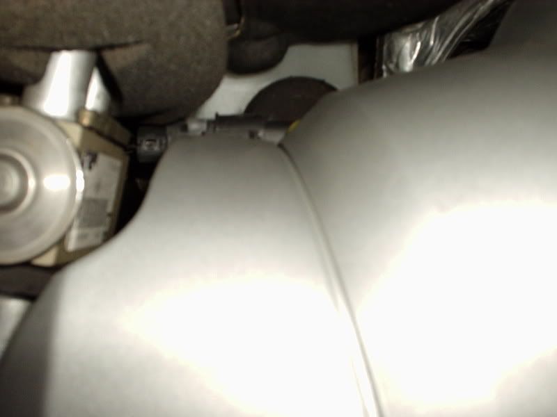

First of all lets find the reservoir...
Hmmm, can't find it...
Wait a minute..
Yes there it is!! Now all I need is the engine out to top it up! Think it's going to be a dealer job, don't want to go lift the engine cover myself. At least I think that's the brake reservoir.

i dont see it there. pull the plastic cover off the engine and have a proper look.
why do you need to top up the fluid? do your brake pads need changing instead?

According to the maual it's on the other side but that's left hand drive only. That's where the pedals are and that's the only fluid reservoir that's not accounted for. It's no big deal, I just thought I'd show it for a laugh. The fluid light is coming on but your right I'll check the pads, they should be OK though.

take of the engine cover and the brakefluid lives down there-i use a syringe

Just done the discs, pads and flexi hoses on my 172, once you get the engine cover off there is enough room to get a 500ml brake fluid container down the back of the engine to fill it up.

I have one of these things. It’s easy for a start take the top cover off and put it somewhere safe, and leave it off until you sell the car. They are pointless and they offer no protection anyway. And they rattle...!
4 torx screws hold it on and that’s it.
