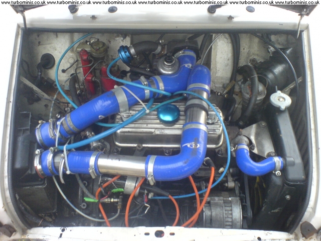

I know that this has been done 100 times before but after searching through all of the previous threads I dtill cant find what I need.
I've got an alloy intercooler from a R5GTT and it's just a little to big to fit on the left hand side without cutting into the inner wing.
I've got a couple of options. 1. Get the saw out or 2. change the intercooler.
Could you post some pics of intercoolers fitted in round nose minis. All of the ones that I have seen don't have a brake servo.
Has anyone managed to squeeze a cooler above the clutch housing without going through the wing?
Thanks!*happy*

It would be pointless trying to do it without cutting, otherwise you will have little airflow !!
I mounted mine in a similar style to the 850 guy, in the inner right hand side guard.
I posted a pic in that thread, although its not that easy to see.

This was mine before I fitted a 2wd Cossie one.Not the neatest install but it did the job! Lol
