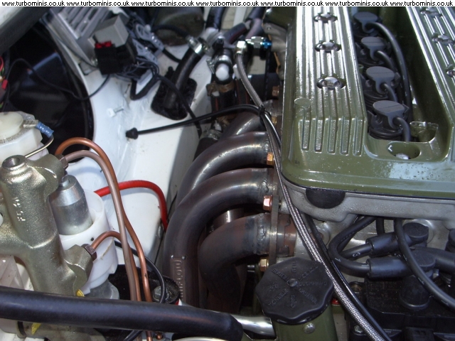

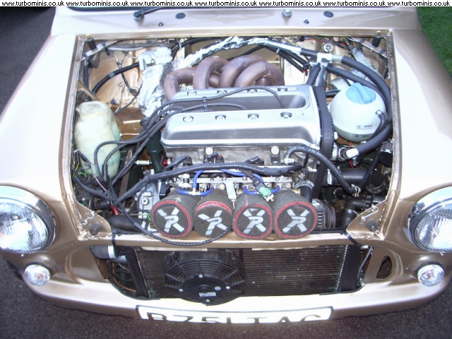

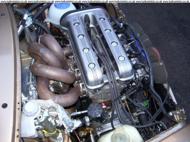

whats with the exhaust bananas on the car? i assume that was a prototype manifold and the clubby has a production one? ( as it has maniflow on it)

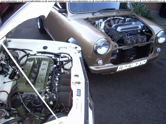

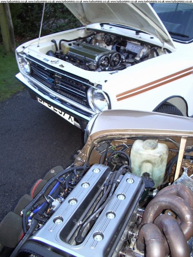

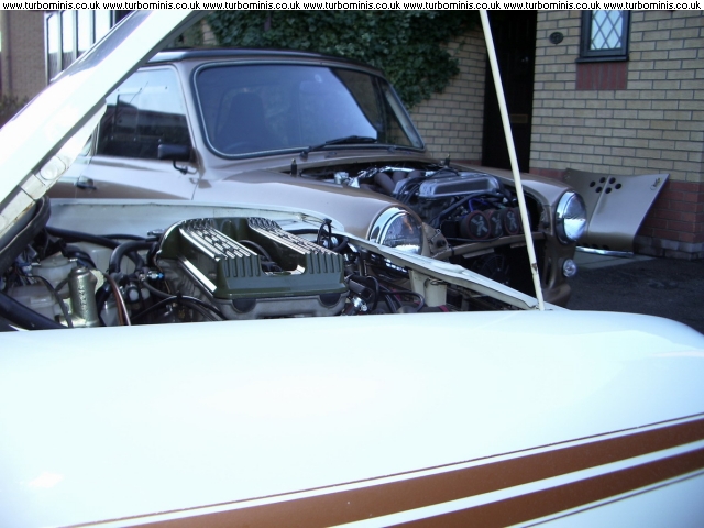

Its interesting to see the install comparison between a round nose and clubby, its suprising how much more room is availble in the clubby bay!

Hi - the gold one is specific to the engine - specific length and pipe dia for the engine at 9000rpm - tuned primary 4:1 - all the lengths up top as 4 pipes of the dia used won't go past the diff housing!

you aren't kidding the clubby has acres of room! - the gold car was the first and therefore lots of development/quick fix bits on it - the vlubby is more productionised.
