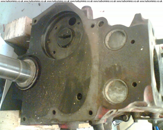

Can you grab a pick of the oil pump end?
As you say the dipstick shouldn't be a problem
plus the compression is easily got round, so its just the oilpump/ oilways.
Can you drop a gasket on and drill holes to mount a std oil pump?

Here's the oil pump end, looks different from what I remember but not realy used to seeing one without pump!
Bigger picture:
