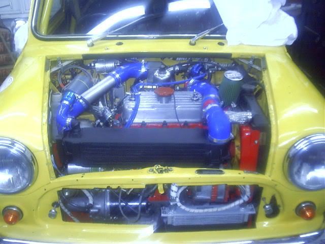

Anyone got any pics of a 2WD Cosworth intercooler in a round nose with a servo and side mounted rad?
Does it fit?
here you go
you need to turn the right hand side cooler inlet 45 degrees have it re welded
hope the pics inspire you

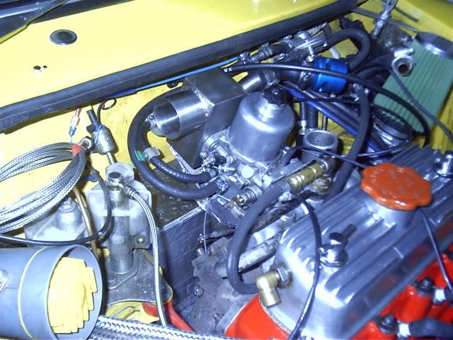

in the last pic you can also see Nics superb plenum he made for me making it alot more easy for the route! and direct flow of to and from the intercooler
Thanks Steve! Thats a great help.
I've got an Escort Cosworth cooler that looks really similar , but it's wider than the 2wd saphire one. There is no way of fitting it unless I had a front mounted rad and ditched the dizzy for a MJ.
I think that I'm better off waiting for the saphire one to arrive.
Thanks again.

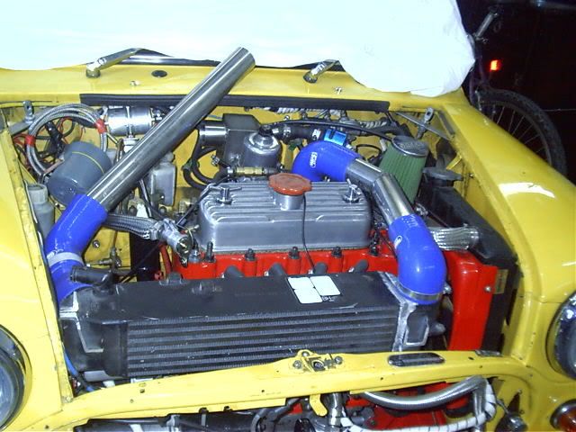

Have you got 2 dump valves fitted in the 3rd pic?

yea it was there on the cooler so i used it just for the bling factor realy ......lol
going to disconect one at a time to see if ........ or any spool up time is improved ?
if i get time after my hip replacement ....lol

Are two dump valves much / at all louder then one?
Thanks.
I think that I might try that. I've got a spare one in the garage!
I reckon that it would be quieter with 2 as the air can escape from them with more ease...
... or is that just twaddle?

i would of thought it would of come out of one ore the other??
My build thread..
about the same sound as one
